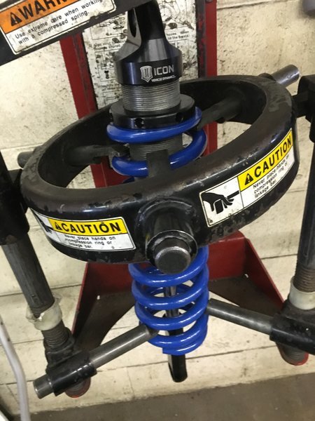

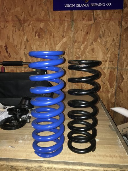

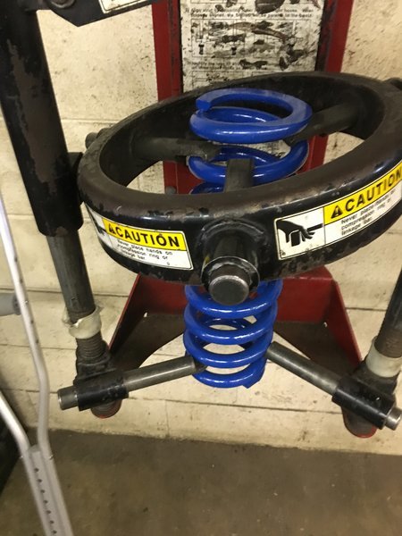

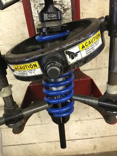

    Difference in 14" 700lb King coil (blue) and 13" 650lb Icon coil that comes standard on the Icon coilover and Ext travel c/o.
    Getting the coil seated
    Slid the shock in. Wound up using less preload on the adjustment nut. No idea where it needs to be once it's installed.
    Squeeze is on! Popped in the lower spring perch. It has a cutout to slide it on the shaft and is recessed on the bottom to seat atop the lower strut mount.
    I just have to put the upper strut mount back on and they'll be ready to install. I removed it for shipping back to Icon service to save weight, and left it off to make it easier to use on the compressor. When I took the old springs off, it was in contact with the top of the compressor. @Bawlmore
