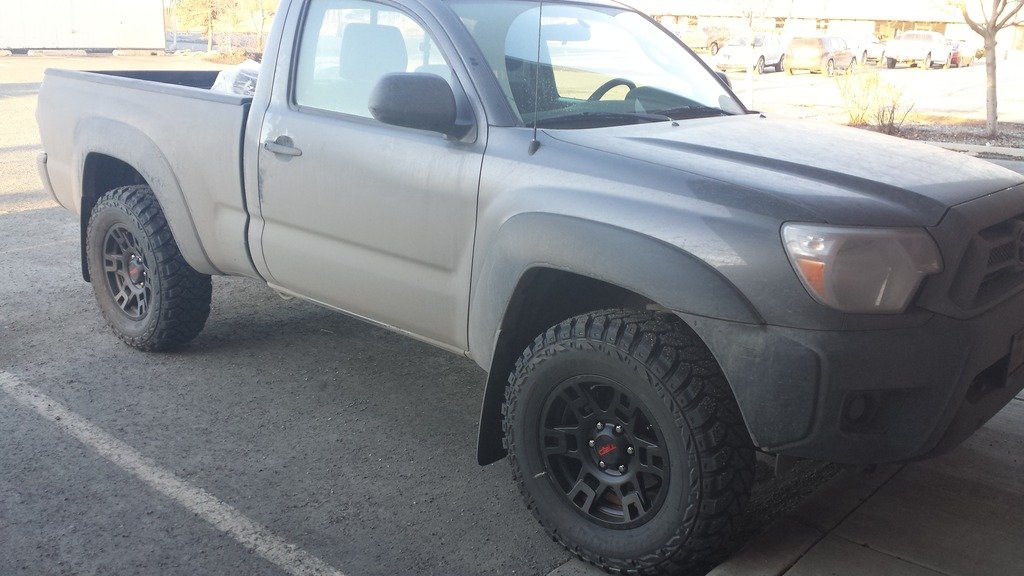

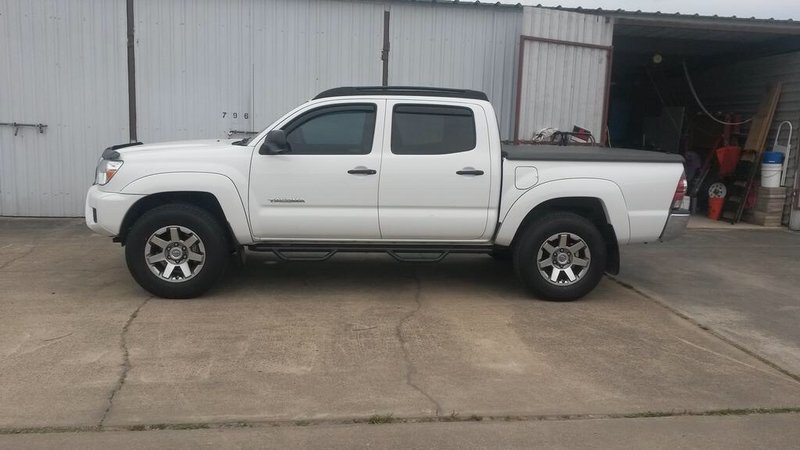

    I really want 17s, specifically Konig Six Shooters:
    But recently I have considered either of these because I can't decide which color Konig to go with:
    or:

    Not bad. Will the backspacing on the other too be an issue?

    shouldn't be an issue on any of them. there are only two tire sizes i will likely ever run in the future, 265/70R17 and 255/80R17

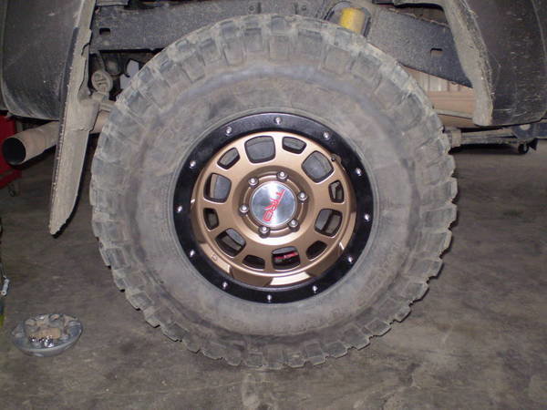

    on the wheels what do you guys think of the trd beadlock wheels? I think these would look good on a white truck with the ring painted black but being such a narrow rim it will limit how big I can go
