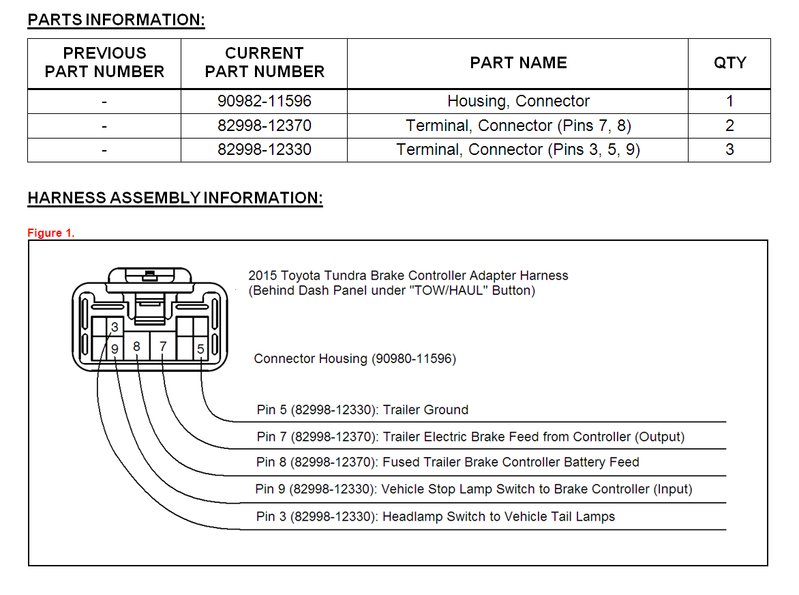

    Unfortunately I don't know the color but maybe this will help. Looks like pin 8

    I figured it out. the fuse isnt blown, its just.... not there. i looked for blown fuses, but i didnt check to see if i had all the ones im supposed too.... ive also noticed im missing fuses for other things... WTF P/O

    That fuse you are talking about is for the trailer brake, you have to install the fuse if you add a trailer brake unit.

    yup, thats what i was trying to do, just needed some troubleshooting to figure out where the fuckup was. as soon as i installed the fuse the controller turned on like it is supposed too. also, WTF toyota, why you use hard to find Lo-pro ATM fuses?
