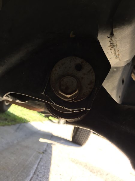

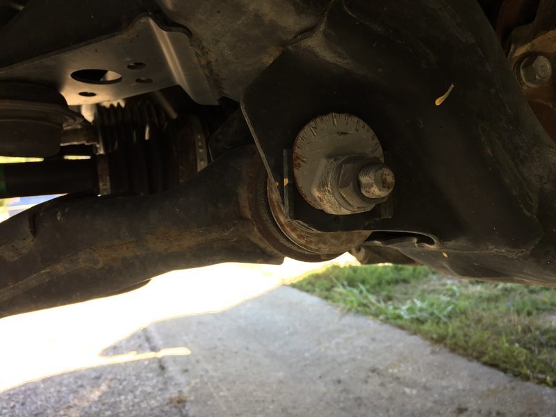

    That was @ST3VE aka King of camber. Alignment should fix it unless the alignment shop can't get enough adjustment, then UCA'so would be required

    Alignment. All we had to do was adjust my toe to get that right.
    You'll need UCAs to clear the coils at droop, if you have that issue

    tires are like that because the alignment is off. weather or not UCAs are needed or not is hard to determine through cyberspace. take a picture of the cam bolts to start, and at least then we can determine if you have any adjustment left.

    Here:

    the good news is that you have a good bit of adjustment left. bad news....no way to tell if it is enough to correct your camber.
