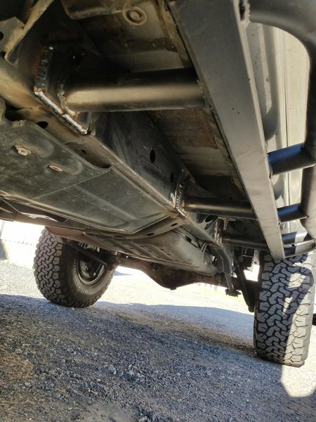

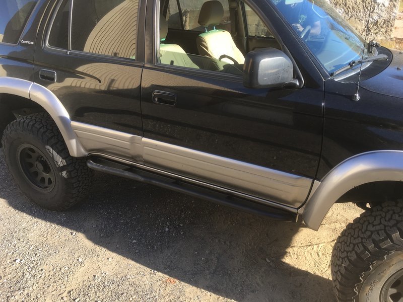

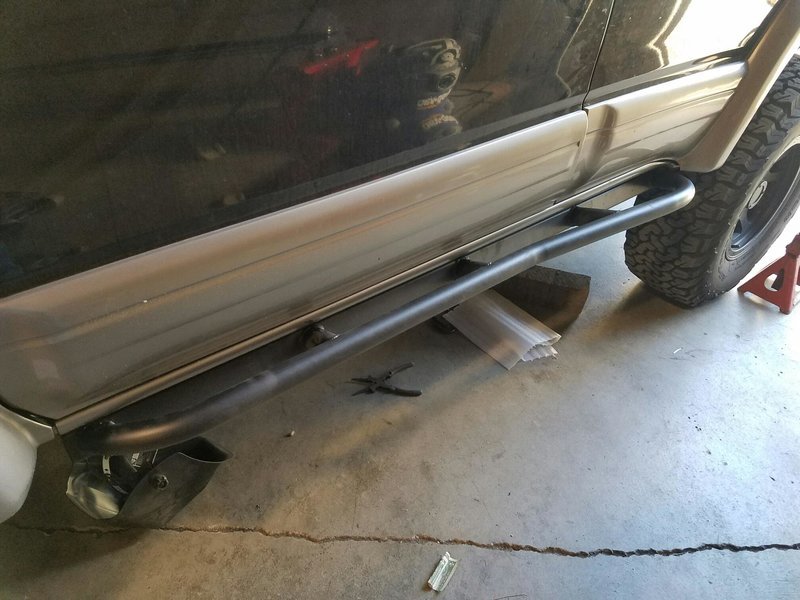

    Built a set of rock sliders and welded them on today. 2002 Limited T4R. DOM tubing hoop with kick out, main tube is 2" square and welded to the truck with 1/4" thick weld plates. Sliders are angled up 20 degrees. @greengen1

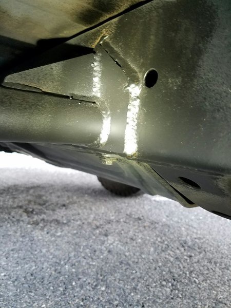

    Show me a pic of where the frame mounts are please

    Killing me. Customer left. I'll see if he can send me some.

    Didn't think to spritz some paint on that shit? Lol

    I was out and didn't realize it. He painted them when he got home.
