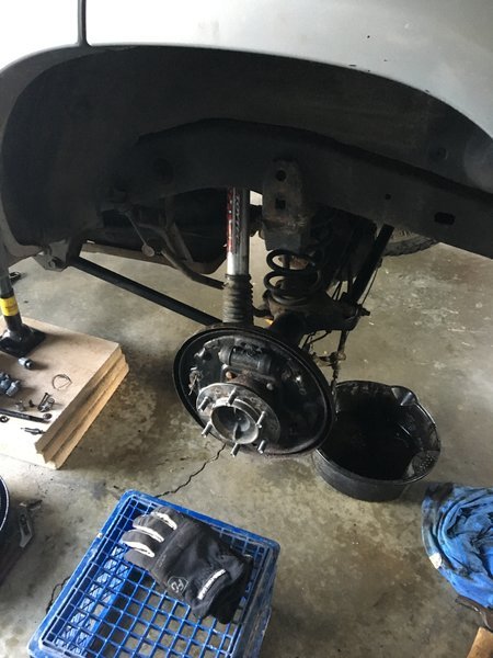

    Need to put brakes back on and change diff fluid

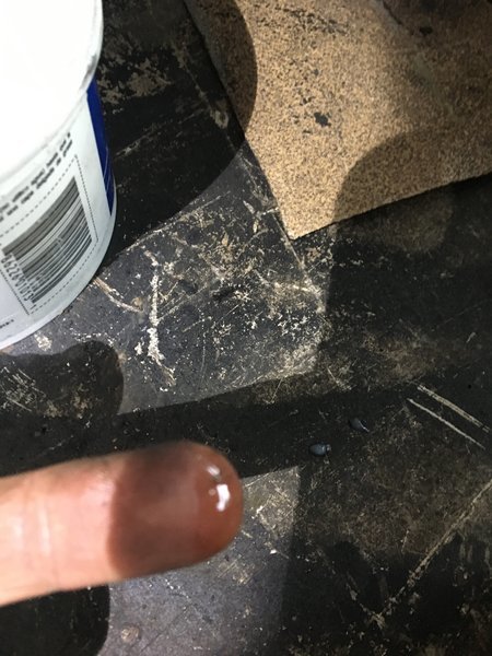

    Diff fluid doesn't look bad for the mileage must have been serviced before

    Who did your press work?

    Didn't do bearing it had very very little play compared to what I saw online so I took a chance at this point in time ..I just did the seal in the tube

    Diff fluid drain and replace done, brakes tomorrow after work and hope it don't leak anymore.

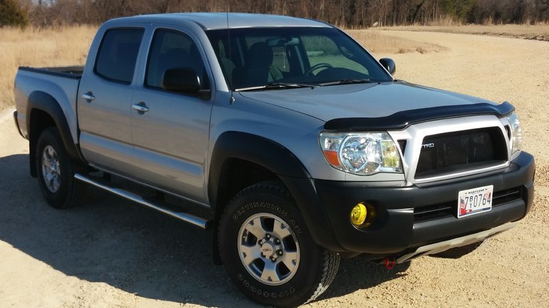

    The weather today was awesome, felt like April right? Wash and waxed the truck, put the Lumin-X on my fogs.

    Shoes look ruined. WOULD REPLACE

    Lamin X ;)
    I only know because i bought some on sale and never installed it :anonymous:
    Looks good. What are your initial impressions about going yellow?

    What are you talking about there fine lol,I don't use the brakes anyway at least that's what my wife says..Actually cleaned them off to reuse for a week until I'm sure it's not gonna leak anymore then will replace it's a shame there's a ton of pad still on them.YEAH I'm a ghetto redneck.

    I like the look on my truck and when I tried them last night they were still pretty bright. They are a pain to apply though.

    Did you remove the housings or do it with them installed?

    I did them installed...probably would have been easier with them off of the truck. The wrinkles are at the bottom of the lens, unless you get close you wouldn't even see em. But I know that it's there:mad::mad:

    Well, that explains it. A couple screws to loosen the fender liner, then unclip the fog light harness and the fog light is clipped in at the adjuster, unclip that and wiggle one side out before the other. It sucks, but it does make it easier. Plus the lights won't come out of adjustment.

    Thanks AR...next time, assuming I don't just replace the whole light with yellow, I'm gonna pull them out of the truck. Checked them today and some of the wrinkles look like they smoothed out abit.
