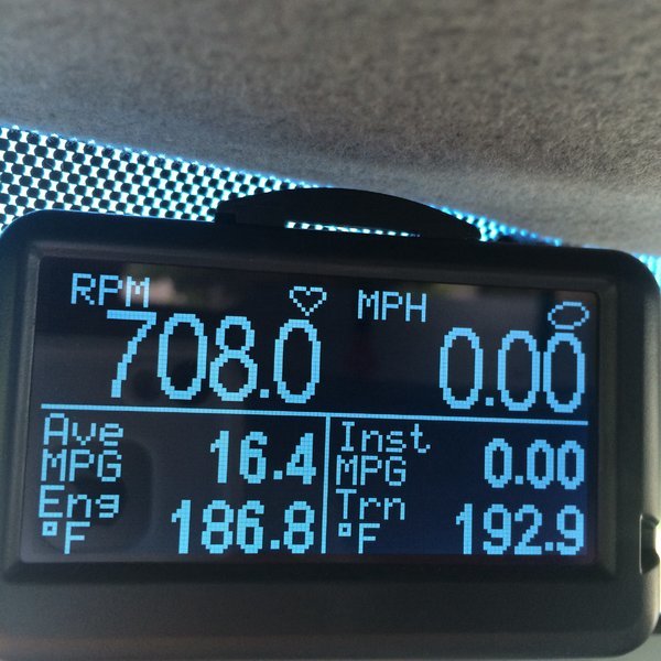

    The hypertechs are supposed to be really glitchy for toyotas so i'll stick to the ol gps

    Gps would be the most accurate ultra gauge or scan gauge would not be accurate since they connect to ecu and it gets info from trans and speedo monitors

    You can recalibrate them.
    My UG has a recalibrate feature, i just have no idea how to do it

    Trans temp is what is most important to me:

    It is pretty simple. You just turn on calibrate and drive for a mile in as straight a line as possible. It then shows you the multiplier that it will use to calculate MPH. It also takes a few fill ups to properly calibrate a full tank for MPG. After that you are set for accurate MPH, MPG, DTE, etc. Its a great reference.
