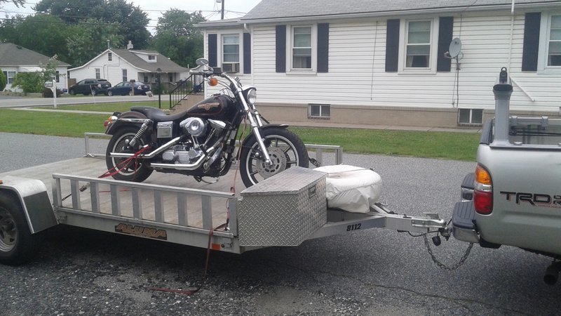

    You could have got around this by flipping the receiver around so instead of it dropping down, it was pointing up. But then you would have obviously needed to flip the ball over too which is tough to do on the fly. I always keep a variety of tongues, balls and a pipe wrench in the toolbox on the truck so I know I can always trailer properly.

    That is absolutely correct. This trailer uses a 2-5/16" ball. Unfortunately the hitch is a drop. The owner of the trailer attached the ball and tac welded it to the hitch so I couldn't put it on a level one. I did have to tow the car in a pinch unfortunately, but it worked out and saved the day. I've been trying to get the owner of the trailer to change the hitch as he has a Tacoma as well.

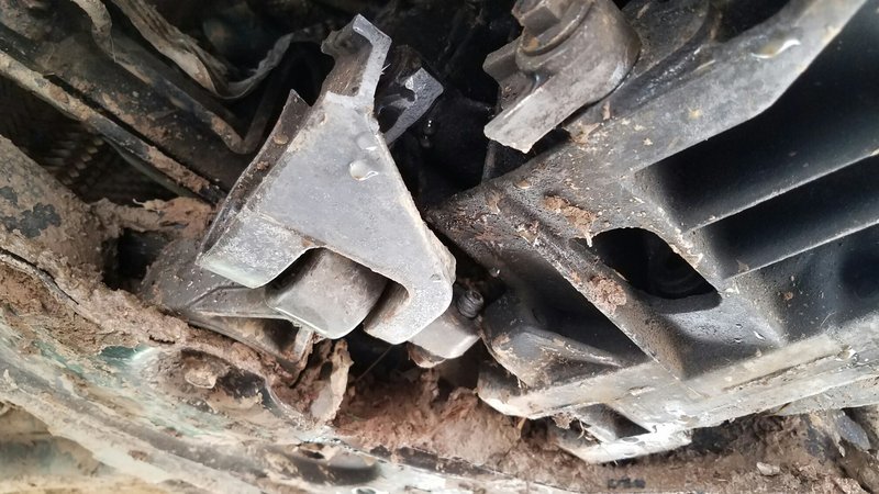

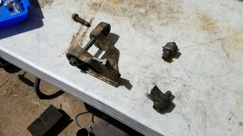

    sweet. I also forgot, the bracket is cast aluminum if that means anything.

    Killing me smalls. Can't really weld cast. It doesn't like heat and wants to crack. Maybe we can make new parts out of aluminum plate.

    yeah, pretty sure heat cycling plus some hard hits caused the failure, got some pictars of it. i found a company that makes a billet piece but a steel replacement would be nice, the dogbone mounts are easy and cheap to replace, this bracket was $30 with $30 three day shipping :bananadead:

    I hate to say it but buy it. No way could I make that.

    yeah, I figured as much since the bolt holes are all on different planes. its just strange, normally you break the Trans bracket to subframe piece, not the trans bracket itself. im also willing to bet that this broken bracket was the cause of the CV coming apart, since when i inspected the CV guts (thanks for catching those skidplate) they didnt appear to have excess wear, its like i just overextended the CV a little and the joint pulled out.
