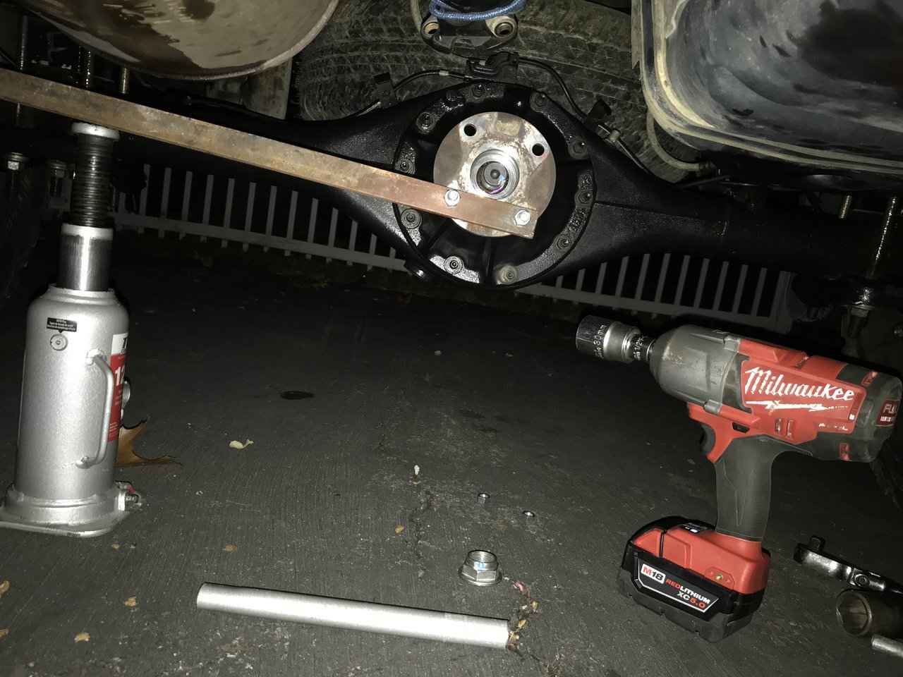

    Whatcha doing ? Besides playing with your rear

    Replaced the pinion seal, and change the diff oil. Never did it before, it was easy!(with the right tools)

    You’d better pray you got that nut back on in the exact same spot. Thats what made my orginal diff blow up.
    Why did you think you needed to replace the pinion seal? Are you running synthetic gear oil?

    I did put it on the same position. My diff was leaking, now Im using synthetic oil.

    Don’t.
    Run lucas 85-140 conventional.
    I thought mine was in the right place too. 7k later. Kaboom.

    You shouldn't reuse the pinion nut either which makes it impossible to get into the exact same place without resetting the gears properly.

    This. I've had synthetic in my diffs for 40k now, is there some magic reason my third hasn't exploded yet?
