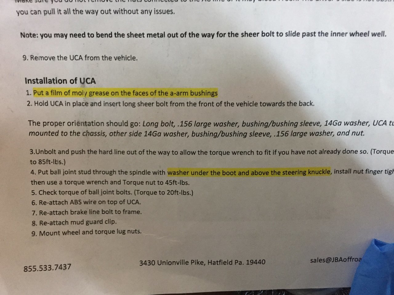

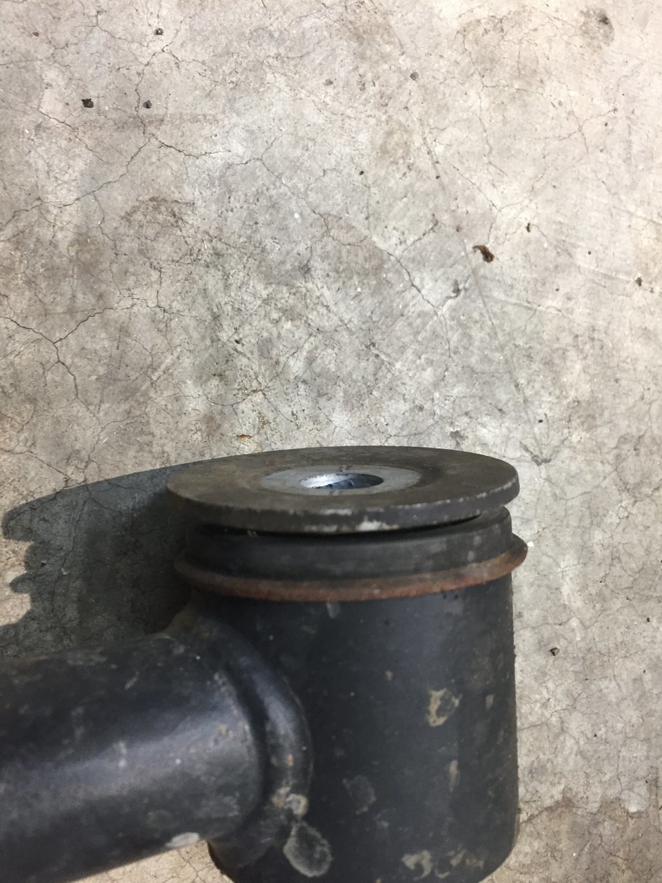

    I called but it’s after hours. They do have instructions, but I’m not clear on that one part
    Oem is washer bushing plastic washer

    There is. I im also assuming when they say .156 large washer they mean thicker vs the 14ga washer. One washer is thicker but the other has a larger diameter.

    That’s what it looks like, but other UCAs do it differently. My problem is I ordered them assembled, which to me means I don’t have to disassemble them to put washers in. Which leads me to believe they get installed like TC UCAs where the washers are on the out side of the bushings.

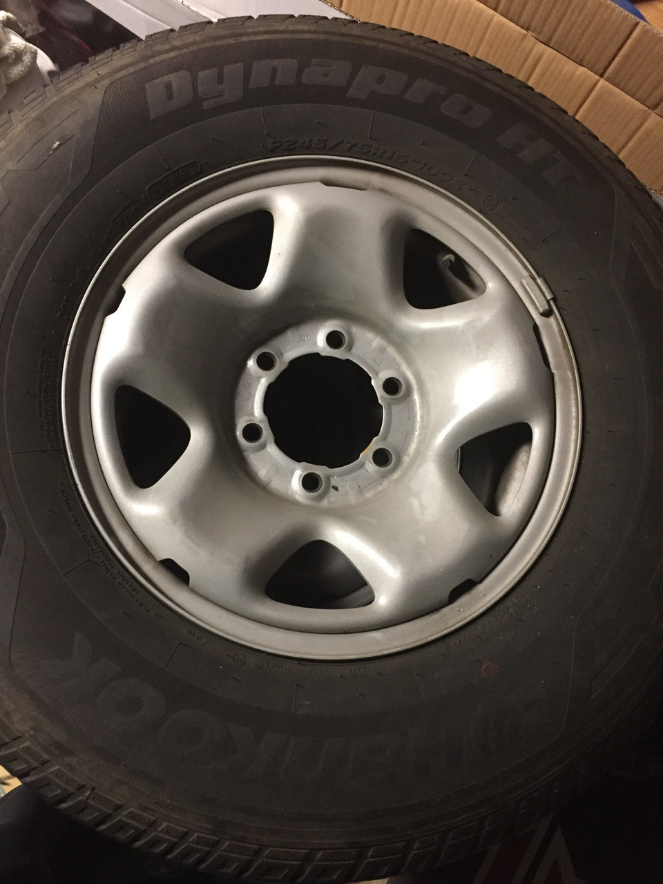

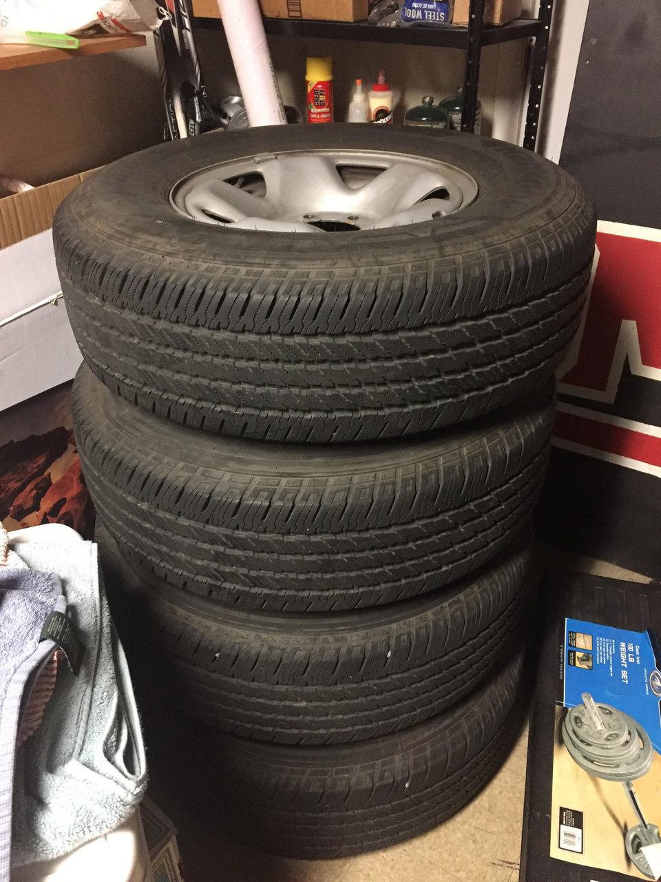

    What do you think is fair for this set of wheels and tires? Also entertaining offers if anyone is interested before I post in the for sale sections/facebook/craigslist.
    245/75/R16 Hankook Dynapro HT
    Steel Rims off 2017 Tacoma SR
    4 TMPS sensors, center caps and lugs
    Taken off at 10k Miles, stored indoors

    My son sold his for $250 on Facebook with 20k on the tires. Sold within 2 days. GLWS

    There is a TW member selling a similar package for $200, minus the center caps (he sold them separately for $50):

    I sold mine for $220 with tires, center caps, lugs, and tpms

    The thicker washer's go to the outside and the thinner washer's go to the inside

    @Sundance47 sorry I didn't see your washer text until today. I was camping and had absolutely zero service. I'm just now catching up with this thread. IIRC my UCAs didn't come with any washers at all. Just the small one that goes on top of the spindle, as mentioned in step 4.

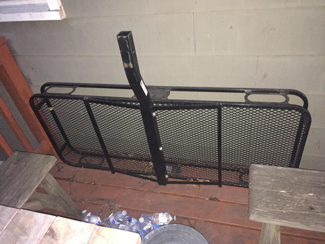

    Funny, I have the exact same one for sale, with a fold up adapter, that I used for my 4Runner. Great minds think alike :thumbsup:
