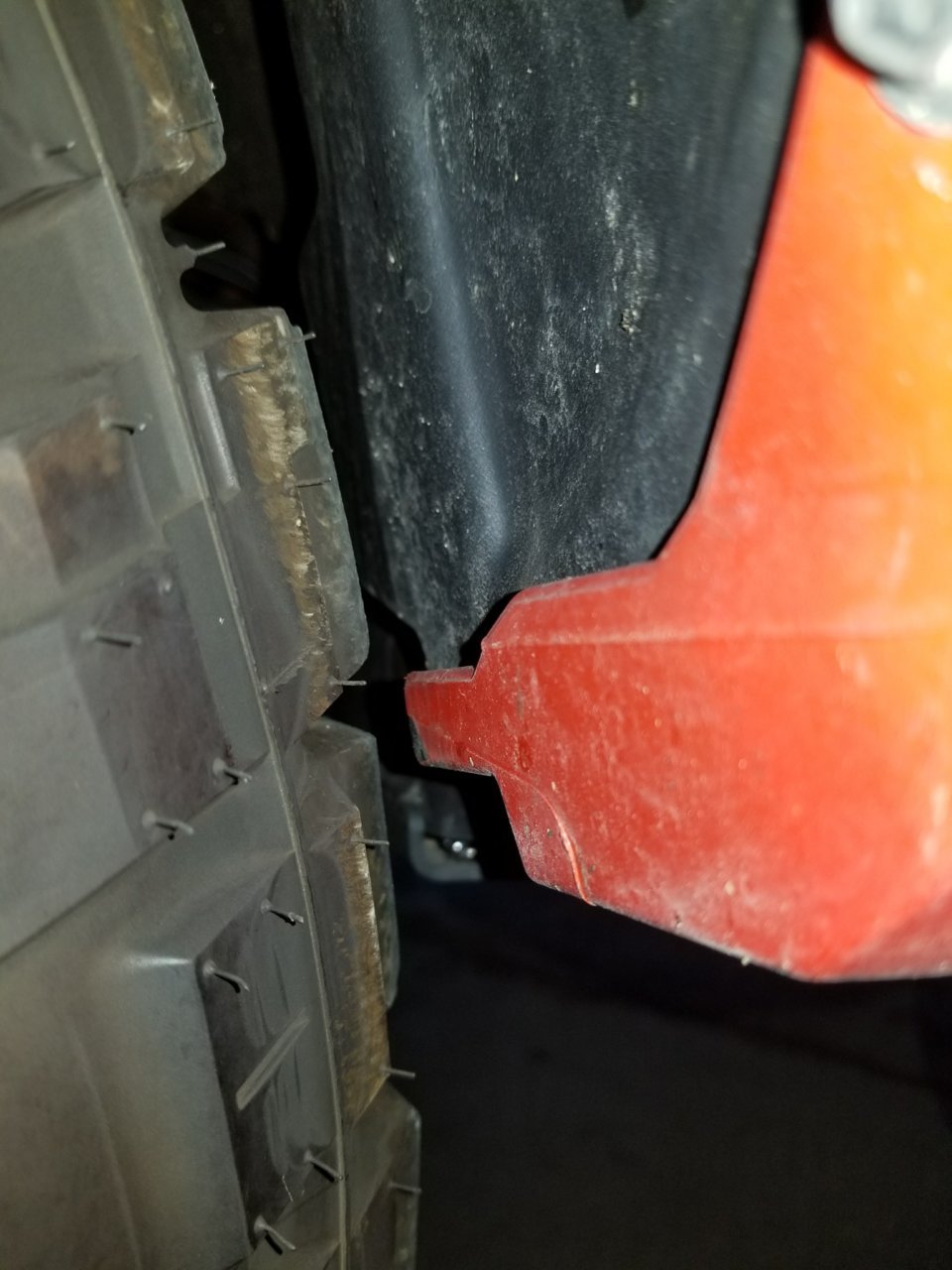

    Bet this is the culprit!
    That little plastic thingy right there.

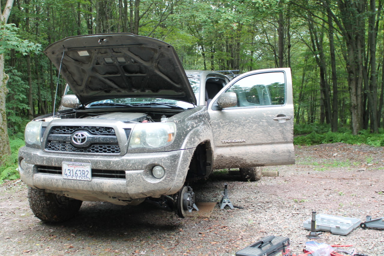

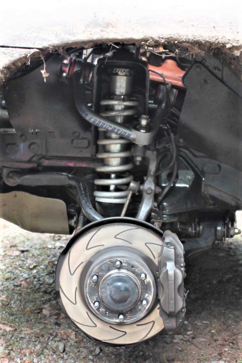

    My dang broken UCA bolt lol

    Did you ever figure out how it broke Peter?

    I could only think of stock front bumps were a wee bit short so when I hit something like a strong bump it blew the bolt LOL. It's a damn hefty bolt I have no idea.

    Hmmm, crazy, so the fix is taller front bump stops I suppose.

    That's my educated guess. Total Chaos, was like that's unheard of when I broke the bolt. Looking at the bolt, it's freaking thick! I'm going to get TC gussets for the UCA for sure.

    @hualampeter I know you're already in contact with the team regarding this. Any pics of the bolt would be appreciated :) It helps us determine what caused the failure.
    We don't want you to blame the bump stops. When the bump stop is the issue it will cause the uniball to bind and transfer the load to the 9/16" bolt that goes through it. This would result in a bend there and not at the main pivot bolt.
    I noticed you mentioned looking for aftermarket Grade 8 hardware - the OEM bolt is the best option on the market
    Very glad this wasn't worse! Looking forward to getting you back on the trails :)
