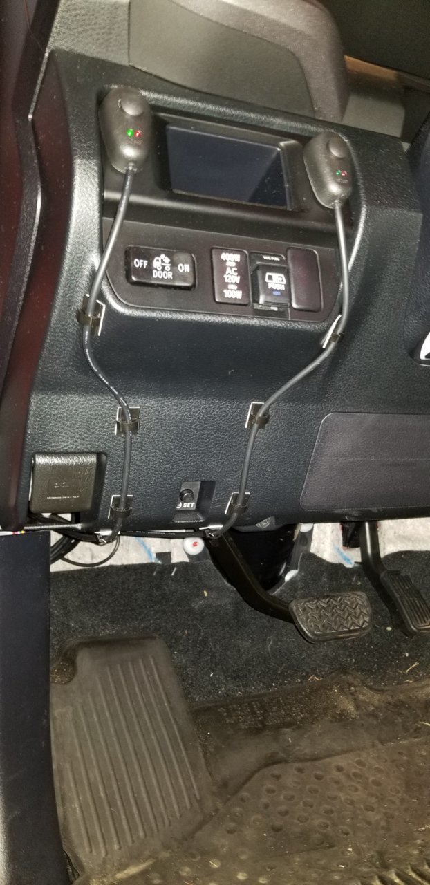

    Rob, so I have similar harnesses. I confirmed that I did connect the switch indicator lead to the 20A Door R/L fuse. It only has power when the truck is on. However, I can still turn the lights on with the truck turned off because the switches main power is pulled directly off the battery via a harness with an inline fuse and relay.

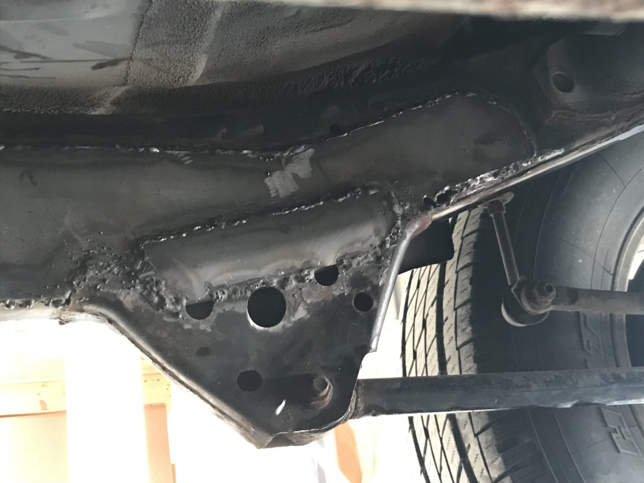

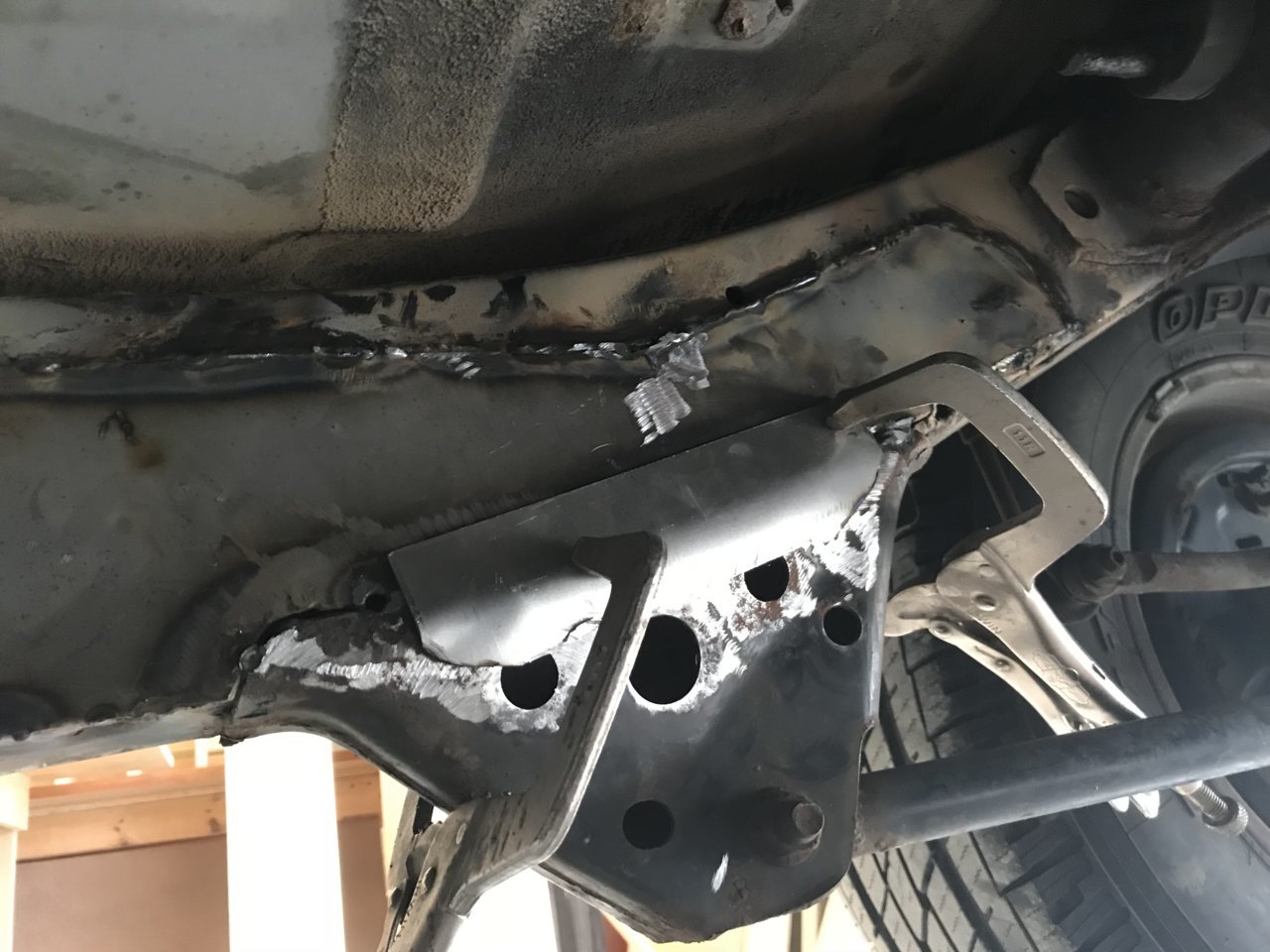

    Make sure you use a hammer and tap around the holes and the rest of that area. I had the same thing on my 4runner and ended with a big patch
    3E75E795-10B6-4401-BD72-691EAAC67CDF.jpg 173B5557-144D-4A20-8255-4478AC8A219D.jpg

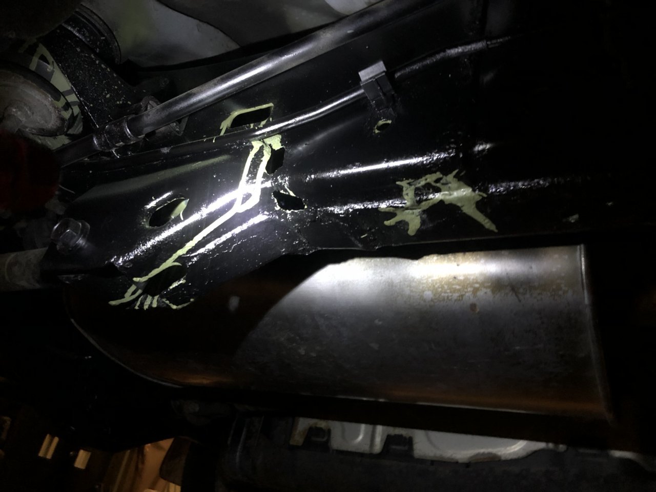

    Here’s the pic of my damage:
    Worst of it is where the holes themselves are, then the perforation extends to the portion of frame that is directly above the rear LCA at its mounting point. But not the whole area, so it seems a lot of what is welded is solid. I see now that the area in question is where water likes to sit with nowhere to drain unless you somehow park in a big hill lol.
    I’m thinking of buying something like this and just replacing the whole area, having some shop cut the slag then weld it on.
    https://www.autorust.com/product/mid-frame-section-w-rear-lower-trailing-arm-mount-art-202-r/
    I am now paranoid and went around the whole frame with a hammer and screwdriver and can’t really find any other issue spots. The front auxiliary crossmember that the front skid and trans cooler line mount to has a couple pinpoint spots but that’s all I could find.
    The ass end crossmember looks ugly as hell but seems to be solid also. I need to pull the rear bumper and address that area.
    I’ve been wire wheeling the frame, phosphate converting rust and then painting with final goal as fluid film or comparative coating. Inside of frame has been hit with Eastwood internal frame coating.

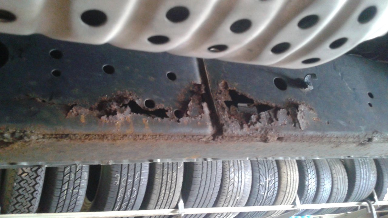

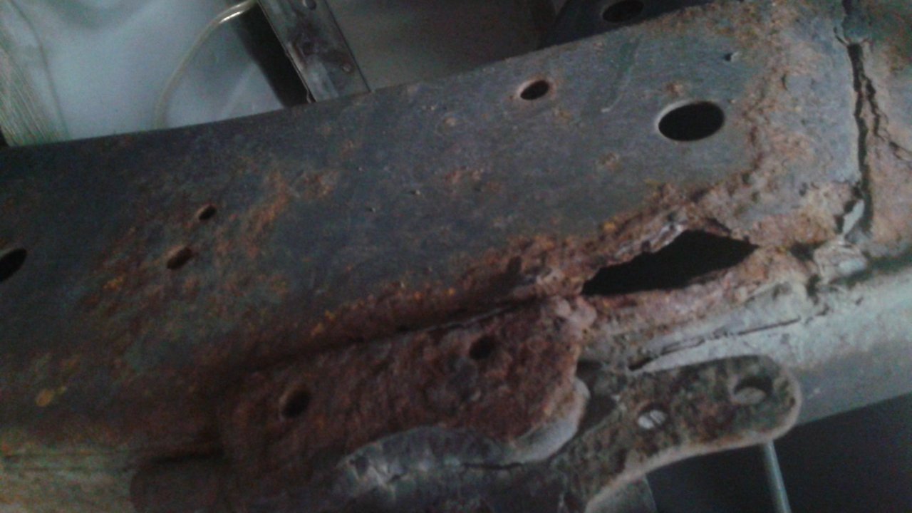

    This was the frame rust on a 04 Tacoma TRD that i bought off of a fellow TW member a few years back for cheap. I had it patched by another TW member and so far no issues, my stepson drives it everyday. I agree with Tonymontana (i'm the one that found & gave him the bad news about his frame) tap all over that frame with a small hammer and/or a screwdriver to determine the magnitude of the rust. But once patched and with proper rust prevention you should be good to go for a while.

    Thats right!
    @68dave found out just an small area; once I removed the muffler I was surprised how bad that part of the frame was.
    At least @JdevTac , that area is exposed and easy to work with. Do an inspection and test the inside of the frame (muffler may need to be removed) on that part, if that is ok, you should be fine, just patch those holes and you are good to go!

    That sounds just like how mine are currently wired. Now I just need to buy the new switch.
