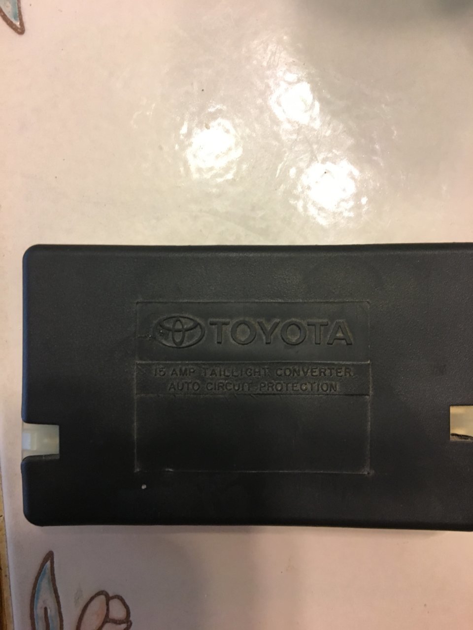

    Now trying to figure out my own trailer light demons on my test light only. The tail lights work no brake which is not good since I hooked up trailer with a load to go to dump and no brake or tail working

    And the only thing working at the factory circuit protector/converter is the tail lights and I can’t seem to find a part # for Oem replacement

    Anybody got one of these laying around

    Great looks like I’ll have to get a aftermarket kit and do some wiring magic since factory part isn’t listed on Camelbacks sight either

    Did you check rockauto? They've got done weird stuff I couldn't find elsewhere someone's
