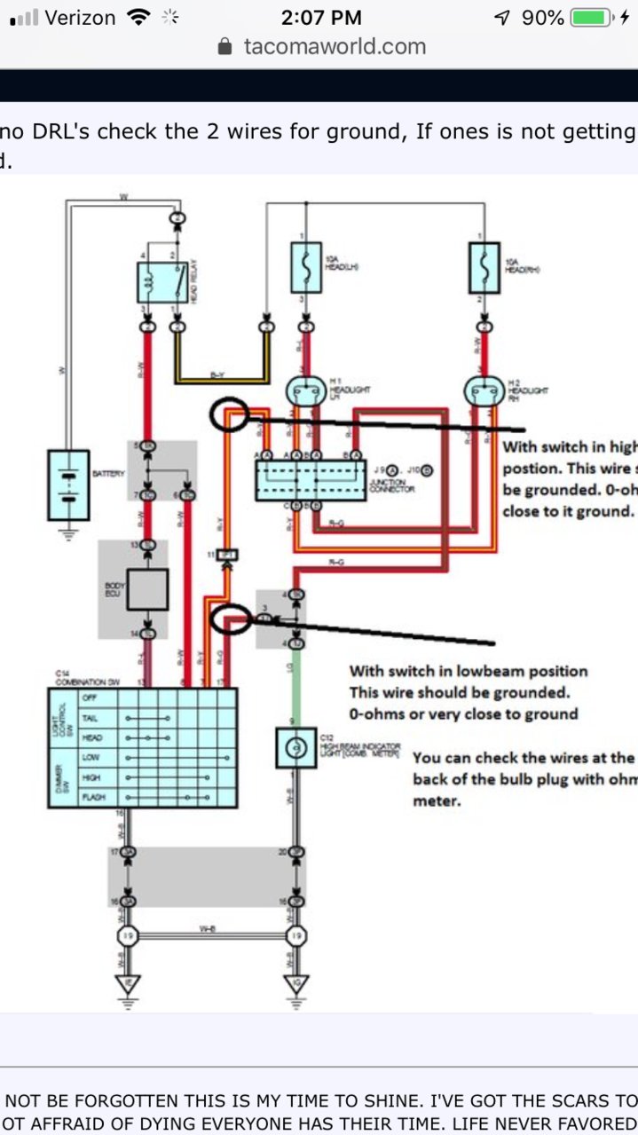

    Fellas, my buddy has a 98 4runner and the low beams stopped working out of the blue. Sometimes they work, sometimes they don’t. We know the bulbs are good. Relay seems fine. No fuses are blown. So this leads me to believe its a bad ground?
    Where is the ground?
    Any advice on fixing this?

    High beams and all other functions of the stalk/switches work.
    Relay clicks on and off.
    So i’m guessing ground. The turn signals are said to share the same ground as the low beams...when we turn the signals or 4ways on, the head lights act like they want to work...

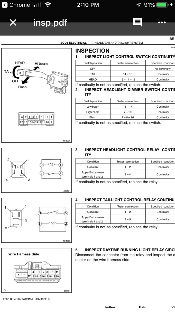

    He did put some silverstar ultra sylvannias in right after he bought it, maybe a year or two ago...so we’ll try swapping the bulbs first and go from there.
    The shop manual i have should have the wiring diagram in it somewhere

    A relay can click on/off and still be bad if it isn't pulling the armature all the way and making poor/intermittent/no contact. I've come across this before.
    Since it's ground switched, it is probably inside the cab under the dash. 2nd gen Tacomas are ground switched for a lot of there systems as well.

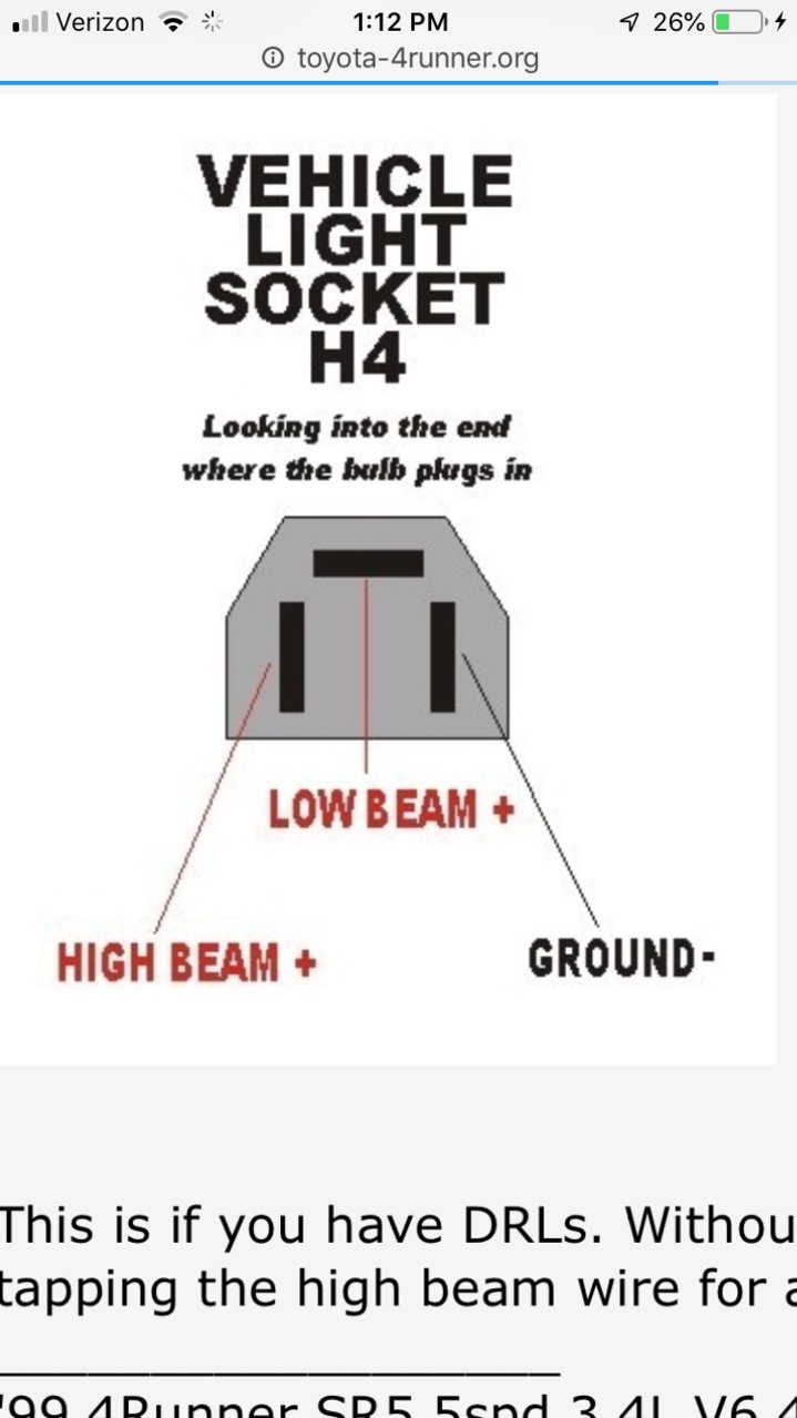

    01C2A34D-28DA-4463-98B8-3F84E759DFB9.jpg A59642D8-18BE-4681-9E09-A2F08A2DE9F5.jpg F3DC070D-47F4-4873-AEC4-F2DFF1D9610F.jpg
    1 of these is a 1st gen taco pic and another is a later 3rd gen runner
