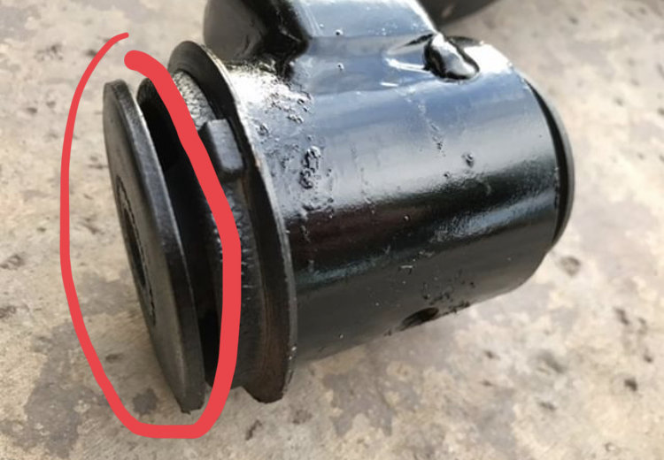

    It’s not hard to avoid doing that. Just cut a little bit, try and chisel it out, cut a little more, etc. On the ones I took my time I didn’t cut the actual lca. You can do it!
    For fire, I recommend the propane torch that hooks to a 20lb bottle from harbor freight. Will turn that bushing to ash in minutes.
    Before you do that, cut off the outer “washer” and it’ll drop right out, leaving you with the sleeve
