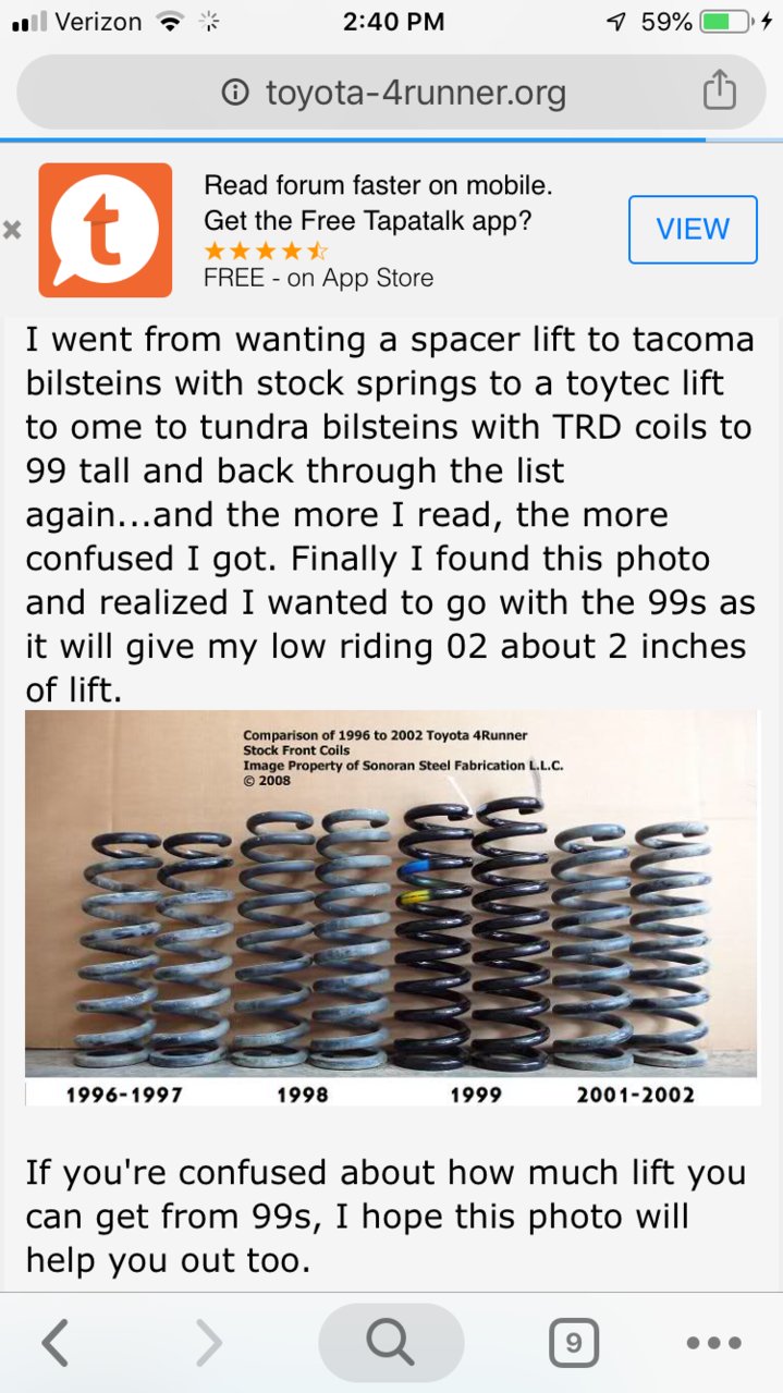

    Also the rear of this 4runner is pretty saggy. Anyone have any idea what rear springs i shoyld stuff in it?
    Looking through moog, ac delco, and whatever else rock auto carries, i’ve seen springs in length from anything around 13”-16.4”
    I’m guessing get the tallest ones I can find and stuff them in there? May do the shocks too.
    The front already has monroe quikstruts on it that are fairly new and not leaking, so I will leave them alone.

    Dude I still have my 99 stock springs(limited had the tallest) out of any year runner there your for free if you want them .I just don’t remember which is driver or passenger sides

    I know it actually matters on second gens side to side, so i’m sure it would matter on these too.
    I appreciate it. I have to do some research because i don’t want it to be tail high too

    I thought the 4runner Highlander model had the tallest?

    My 99 talls will give it a slight lift of 1.5 or so

    Brian, @greengen1 can you measure the length of your springs for me?
