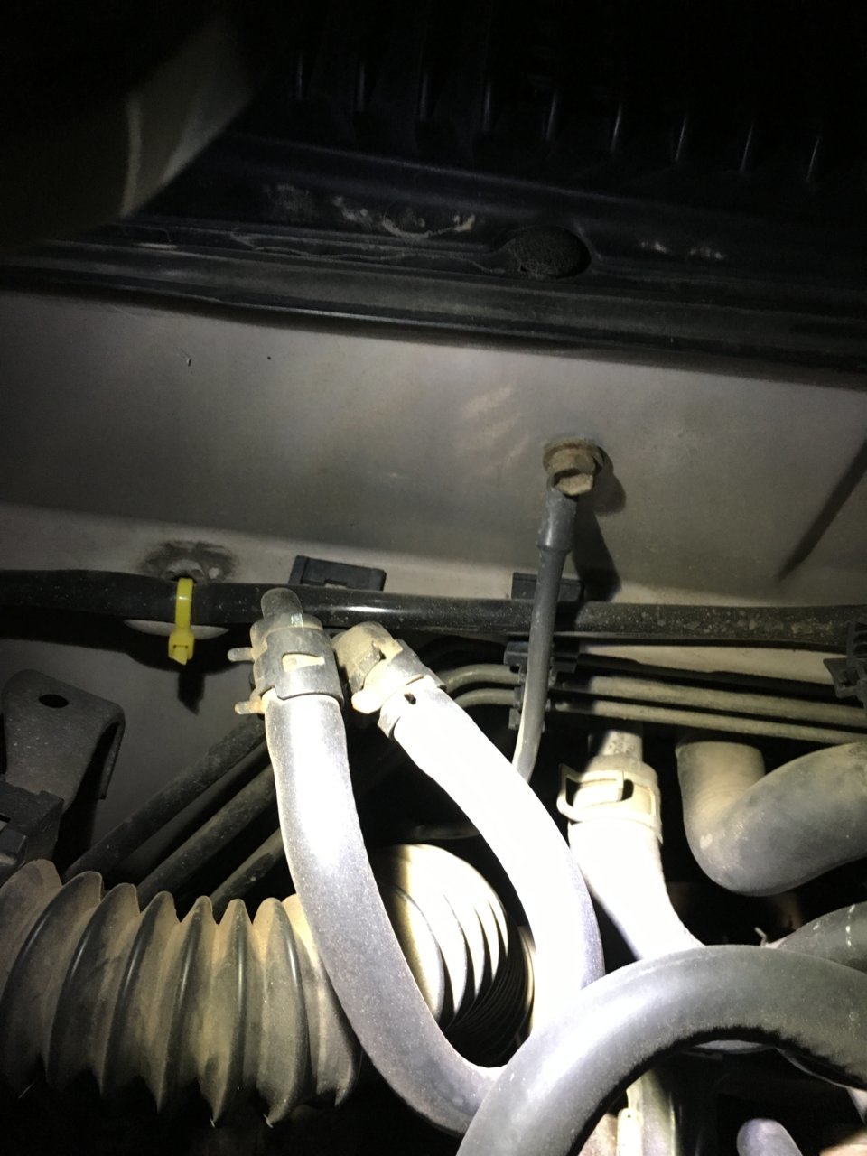

    Mine were leaking too. Dealer price is about $250. One day I went to the junk yard and found one almost new, price was around $15. Just 3 or 4 10mm bolts; very easy to remove and reinstall

    Just bypass them at the control valve, there’s a thread on t4r.org ,might also be one on4runner.com

    Stick a bolt in the line or what? Put some caps on them?

    I put stickers for more horse power!
    I just bypassed when I did not have a replacement part. No big deal
    You need about 6” of I think 3/8” ID hose

    3inch Toytec lift ,285/75/16 ,elocker with stock 4.30 gears ,CB ,4ft firestik ,mag lite mount ,roof basket with shovel mounted ,Ultra gauge.And other stuff.
    I can’t get a good pick right now but will tomorrow
    AR15xAR10 likes this.
    Will get pic of valve tomorrow
    RobP62, Tonymontana and AR15xAR10 like this.

    2013 TRD Sport 4x4 V6 ACLBFTMFW
    Awesome. I want to loop it at the top, cut out the hard lines and loop them at the bottom. Because the hard lines are toast

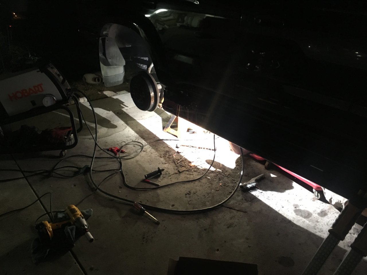

  16. Aug 29, 2019 at 6:13 PM
    AR15xAR10
    Apr 13, 2013
    #102024
    56,996
    Still working. Patch work is almost done.
    Just gotta finish it up in the morning and start descaling and painting everything
    68dave and RobP62 like this.

  18. Aug 29, 2019 at 8:55 PM
    AR15xAR10
    Apr 13, 2013
    #102024
    56,996
    I had enough 3/16 angle iron and flat stock laying around to do it so we banged it out tonight. Just gotta grind and clean things up tomorrow.
    Then, i plan to wire brush the whole frame and paint/undercoat it. May use POR15 or something similar. Have not decided yet.
    I appreciate it very much Tony, you’re too generous!
