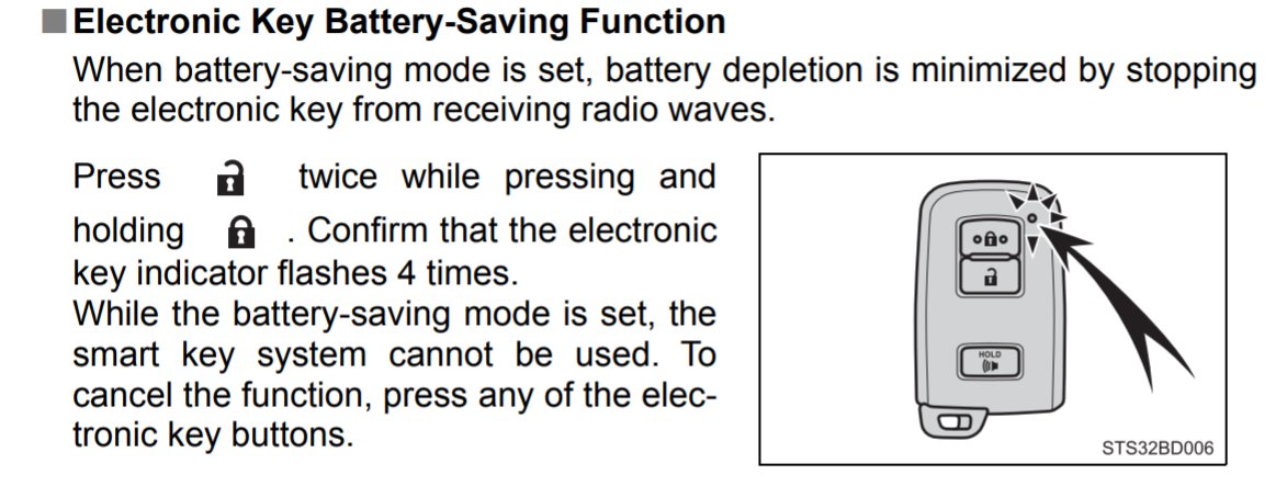

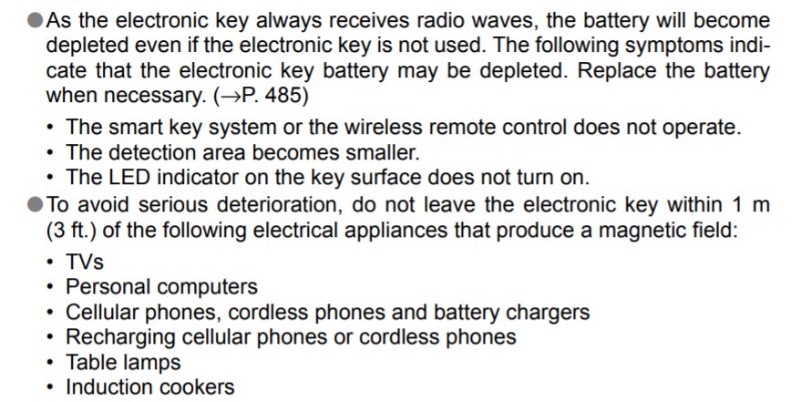

    Just be aware of what can drain the remote battery rapidly:
    There is a way to put the remote in sleep mode, to conserve the battery:
    68dave and Majora[QUOTED] like this.

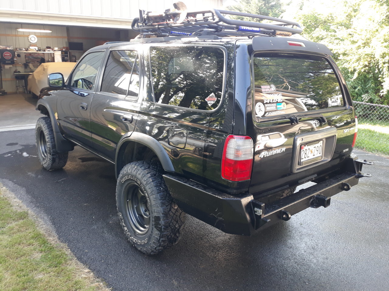

    Since I removed the OEM bumper assembly & frame hitch and installed the Offroad bumper I now have a slight rake. I'm hoping that the swing out attachment will even it out.

    Rake or Bro Lean? Hard to tell form this angle.
