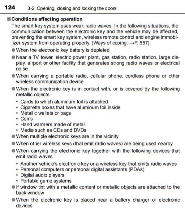

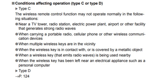

    It's probably going to fall on deaf ears, but I would still try a fresh new name-brand battery. There is a difference on testing a battery voltage using a meter, and testing under load. Your mention that performance has slowly diminished, rather than suddenly as when you added a mod, would seem to point to a battery.
    And, you could try eliminating other factors mentioned in the manual, such as testing in a different location, making sure no other remotes or cell phones are nearby, etc. Maybe try temporarily unplugging potential electrical interference, such the dash cam and GPS module, and see if performance increases.

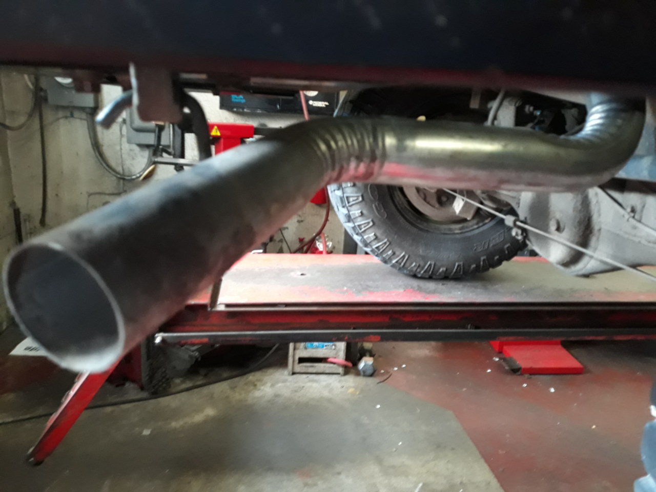

    Thanks to Mobtown Joe for the new tail pipe. Just installed it along with a new muffler. Muffler was the original, 20years old and almost 240k miles so I can't complain.
