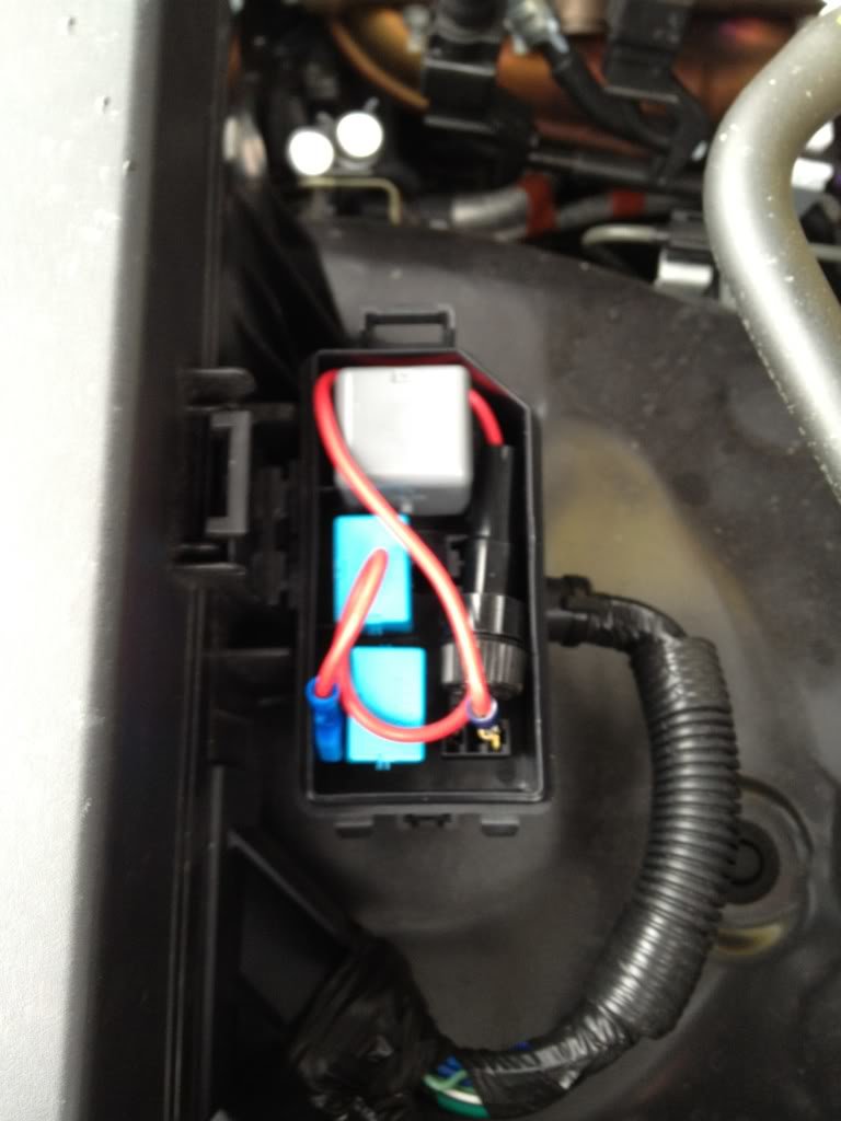

    How hard is the fog anytime mod?

    It's as easy as this...

    So how much are you going to charge to make this wire set up???

    I am willing to help out, it really is as easy as it looks. Bend up the bottom left prong on your fog light relay, connect female end, in line fuse rated at 1 Amp, male end into seat heater terminal...fogs on at any headlight switch position with the ability to still turn them off with the fog light switch...
