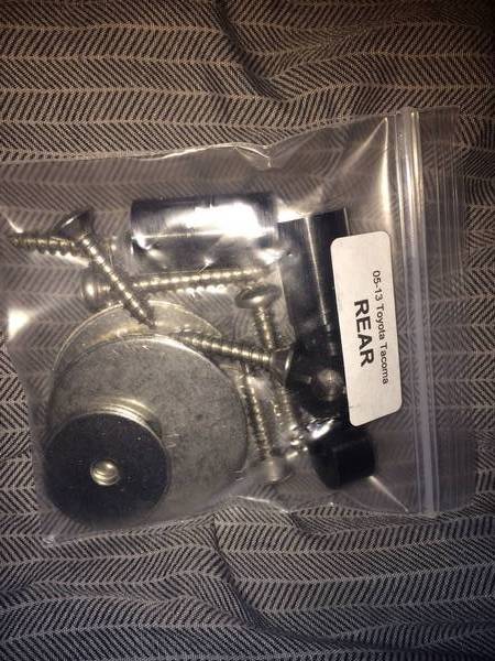

    I got some new toys today! vygunene_4c9ddd60a11eb242aec23d7908c6870f7a8a14be.jpg

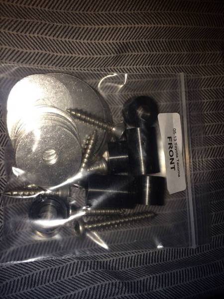

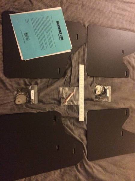

    these are the ones with the brackets for mounting them to the truck right? If they are can you get m some better pics of the mounting hardware? i need a solution for my flaps, im interested to see what other companies have done
