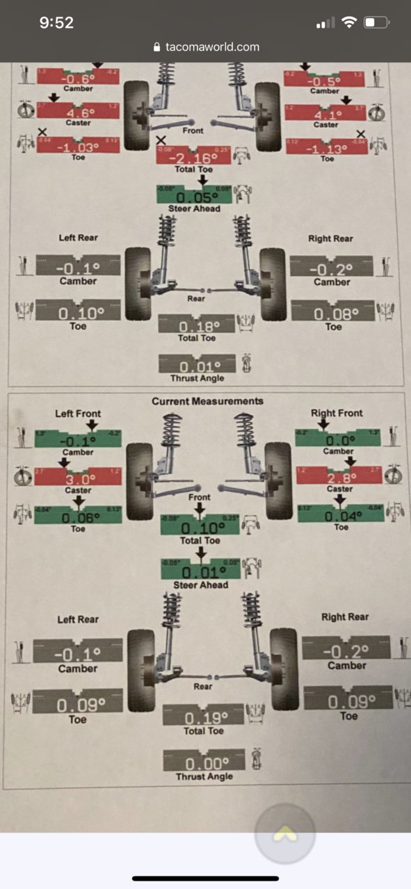

    When I went to the Firestone in Hickory they told me they couldn't do the alignment out of spec. With larger tires you almost need to increase the caster and they wouldn't touch it.

    That's what I'm thinking. I can have them mount the tires at the same time and align with those

    I had them do mine last week… I guess it depends who you get there. Though, I increased mine myself before I took it and told them to leave it alone lol.
    Karen at Jones Junction will help out with out of spec alignments.
    Edited to add the alignment sheet

    Here's what Forest Hill Automotive did for me and why I decided not to ever go back to them. They dialed in the camber and toe but look at the caster. Yes, the truck drove perfectly and I had no rubbing, at first, but as the suspension began to settle after a while the drivers side started to rub at full lock, in reverse. Next time I am going to need to go to a place willing to listen to what I say and able produce the results I want.

    Technically because the new suspension in the rear will pitch the front forward and make the ass end higher, you should wait to do the alignment until all the new parts are on.
    HOWEVER, you can get the front squared away now, put the rear on, and then get it checked out a couple hundred miles after the rear has been on and everything has settled in its place. Thats probably what I would do.
