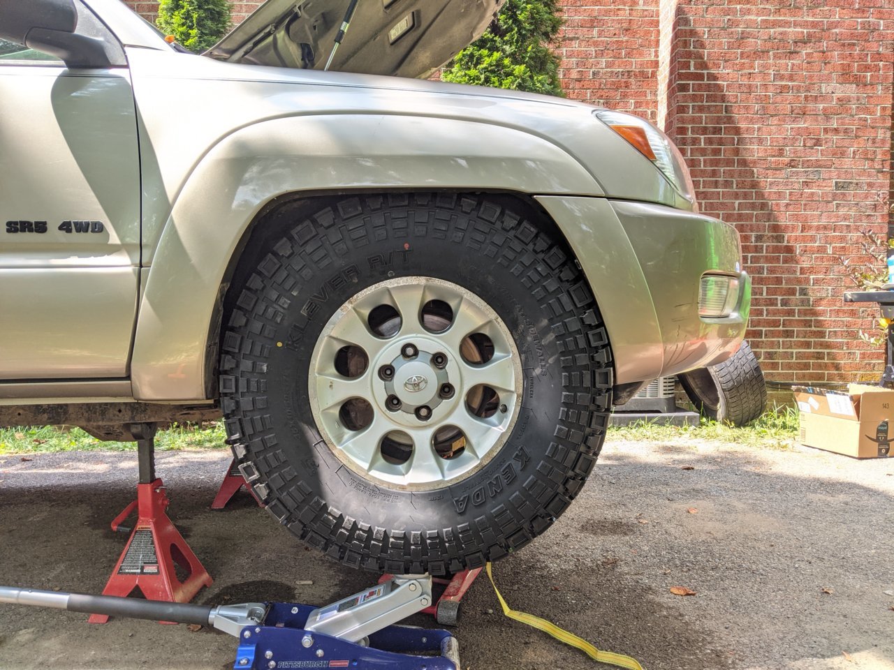

  11. Aug 30, 2021 at 4:56 PM
    y=mx+b
    y=mx+b Station Wagon
    Jul 17, 2020
    #334787
    1,938
    Lafayette, IN
    '05 T4R SR5 v6 4wd
    Lifts don't clear tires, so it's really up to your willingness to tweak alignment and trim to determine what size you will make fit. Reasoning behind why lift doesn't clear tires is that at full stuff, the lift amount is irrelevant. Also consider that caster does not necessarily give clearance at the fire wall. + Caster at the lca will give more clearance, but +caster from the uca will actually reduce clearance
    I'd say if you're willing to just do a little trimming/stretch fender liner, than 265/75/16 or 265/70/17 is a good place to start
    For moderate trimming and body mount chop, 285/75/16 or 285/70/17s are pretty popular choices.
    For moderate to decent amount of trimming, 35x10.5 pizza cutters fit pretty wheel in my 4runners wheel wells, and werent really too complicated to get fit right once I trimmed everything up
    If you do anything more than the 265 options, I'd suggest pulling the front shocks and cycling the suspension droop to bump and lock to lock with a jack and cut everything that rubs

  14. Aug 30, 2021 at 5:51 PM
    y=mx+b
    Jul 17, 2020
    #334787
    1,938
    Lafayette, IN
    '05 T4R SR5 v6 4wd
    830lb/in is quite a hefty spring rate. I don't really have much added weight up front, but I have 580lb springs and like them.
    With springs, an important thing to keep in mine is hooke's law F=kx where F is force (weight), K is the spring rate (like 650lb/in), and x is the spring displacement from equilibrium (preload). Basically what this tells us is that you can support a load with either a higher spring rate OR more preload.
    Also consider the spring rate itself is a rate, which the units of lb/in often gets truncated to just lb and that unit doesn't tell the whole story. Rate essentially tells up how easily the spring is compressed. so a 650lb/in spring will take 650lb to compress 1", 1300lb to compress 2", 1950lb to compress 3". Likewise with an 830lb spring: 830lb to compress 1", 1660lb to compress 2", 2490lb to compress 3". the springs aren't 1:1 on the front suspension because of the control arms, but the concept is the same. The takeaway from this is if you don't have a lot of weight up front, but a heavy spring rate, then your springs will not compress much off road and can lead to a tire in the air. Having a lower spring rate coil will allow your suspension to flex easier, and also not be so harsh on road. Heavier spring are more difficult to flex, and could be harsher on road
    extended bumpstops rob up travel. Most front suspension setups don't actually extend the front travel, just change static ride height. This is because the articulation is really limited on the geometry and not by the shocks.
    imo Preload gets a bad wrap and 700lb springs tend to be overhyped

  20. Aug 31, 2021 at 6:27 AM
    y=mx+b
    Jul 17, 2020
    #334787
    1,938
    Lafayette, IN
    '05 T4R SR5 v6 4wd
    If they're really squishy and compress all the way down to like the OEM size then they're not robbing up travel. I've just seen some people but taller bumps that don't compress to keep the tires out of the fenders, but that's really just limiting the wheel travel.
