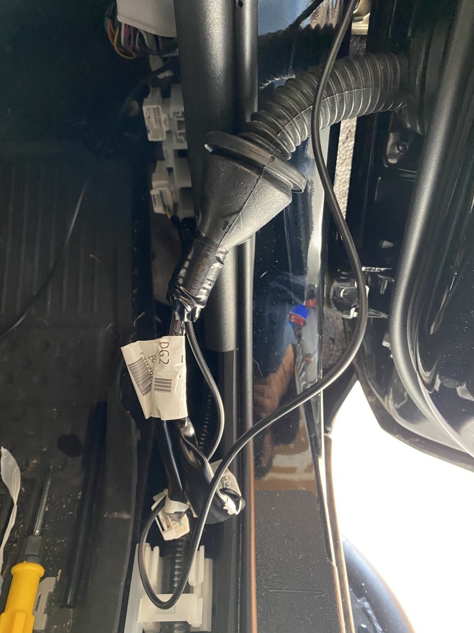

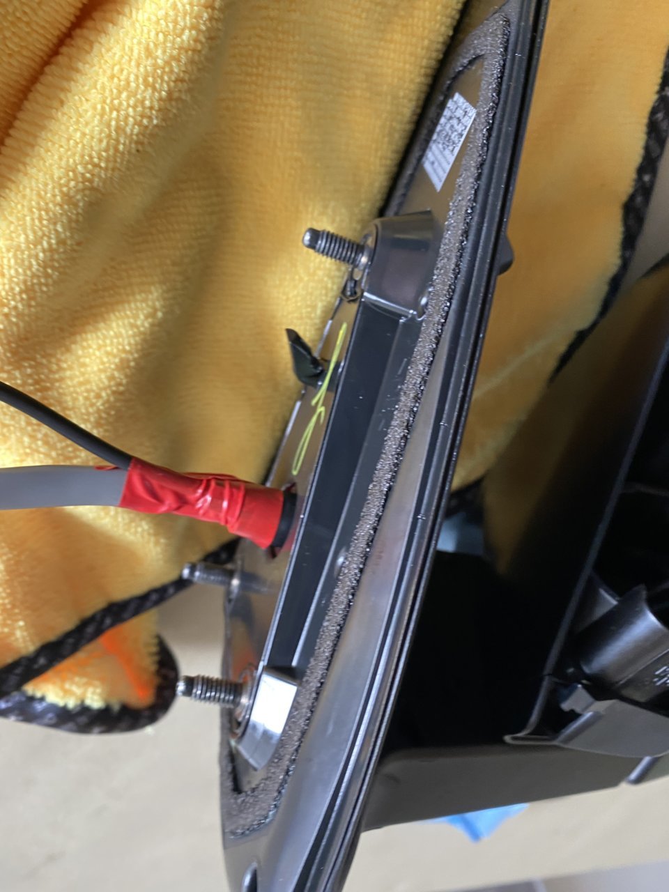

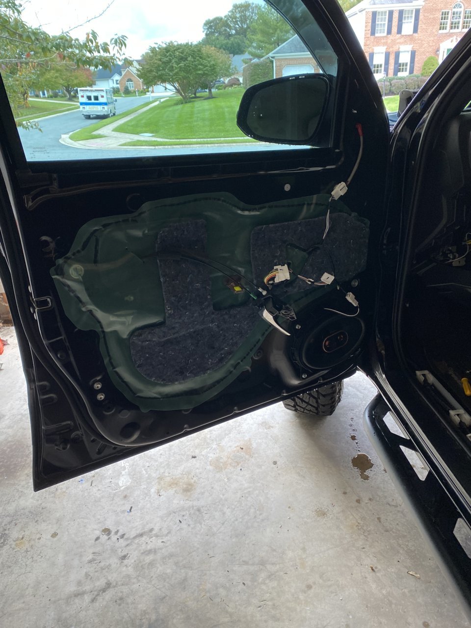

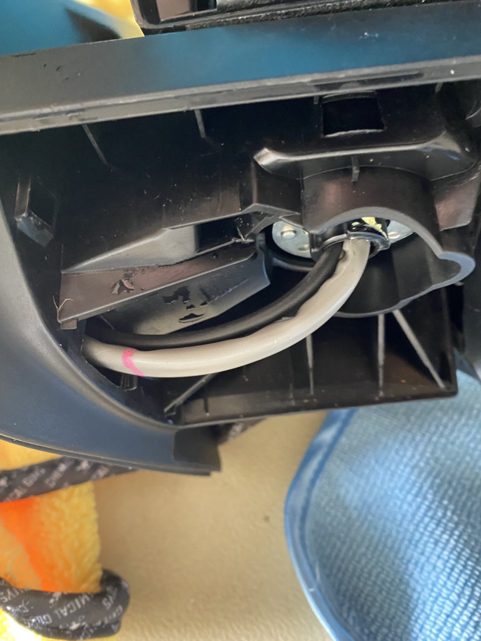

    Ok, then it’s pretty “easy…” well now that I’ve done it. Just a few highlights-
    Mirrors have to come off, door panels have to come off, gotta putt the door to cab conduit out. If you’ve not done it, would be a good chance to change the 6x9s in the donor panel too.
    When I was running the driver side door, I didn’t realize that all the connectors should fit through the conduit hole so work in that small opening in between the door and the cab. You can see the one pic of the passenger side where I tried and saw that they will fit. I needed extra wire for the passenger side to make it to the drivers side headlight. I went through the firewall grommet on the drivers side. And I used a nice bit of zip ties…
