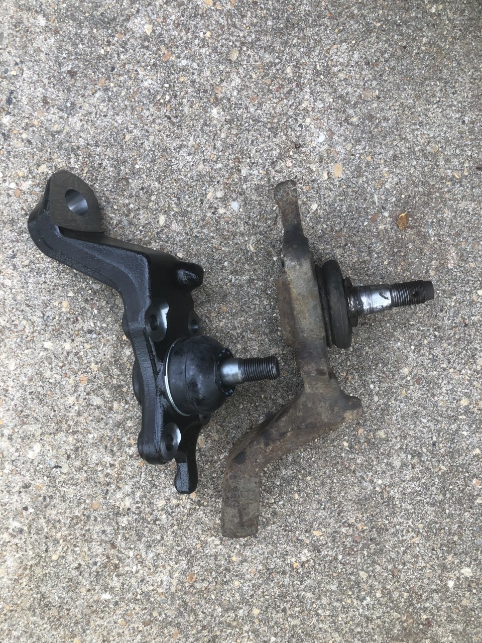

    Morning MD. Changed my LBJs yesterday and man were the old ones toast.. such an improvement in the steering feel

    Have you replaced the original worn rubber rack & pinion bushings with poly bushings yet? Energy Suspension makes a kit for the 1st gen tacos & 3rd gen 4runners. Both my trucks have this upgrade.

    Not yet, funny enough I was just checking those kits out today. Big difference?

    Yes it is. Have someone rock the steering wheel (engine off) side to side while laying under it looking at the rack. I bet you see movement in the rack.

    I've done this to my 3rd gen 4runner, amazing difference to the feel through the steering wheel. Pretty straight forward installation with hand tools, I used a big "C" clamp to press out the big bushing.
