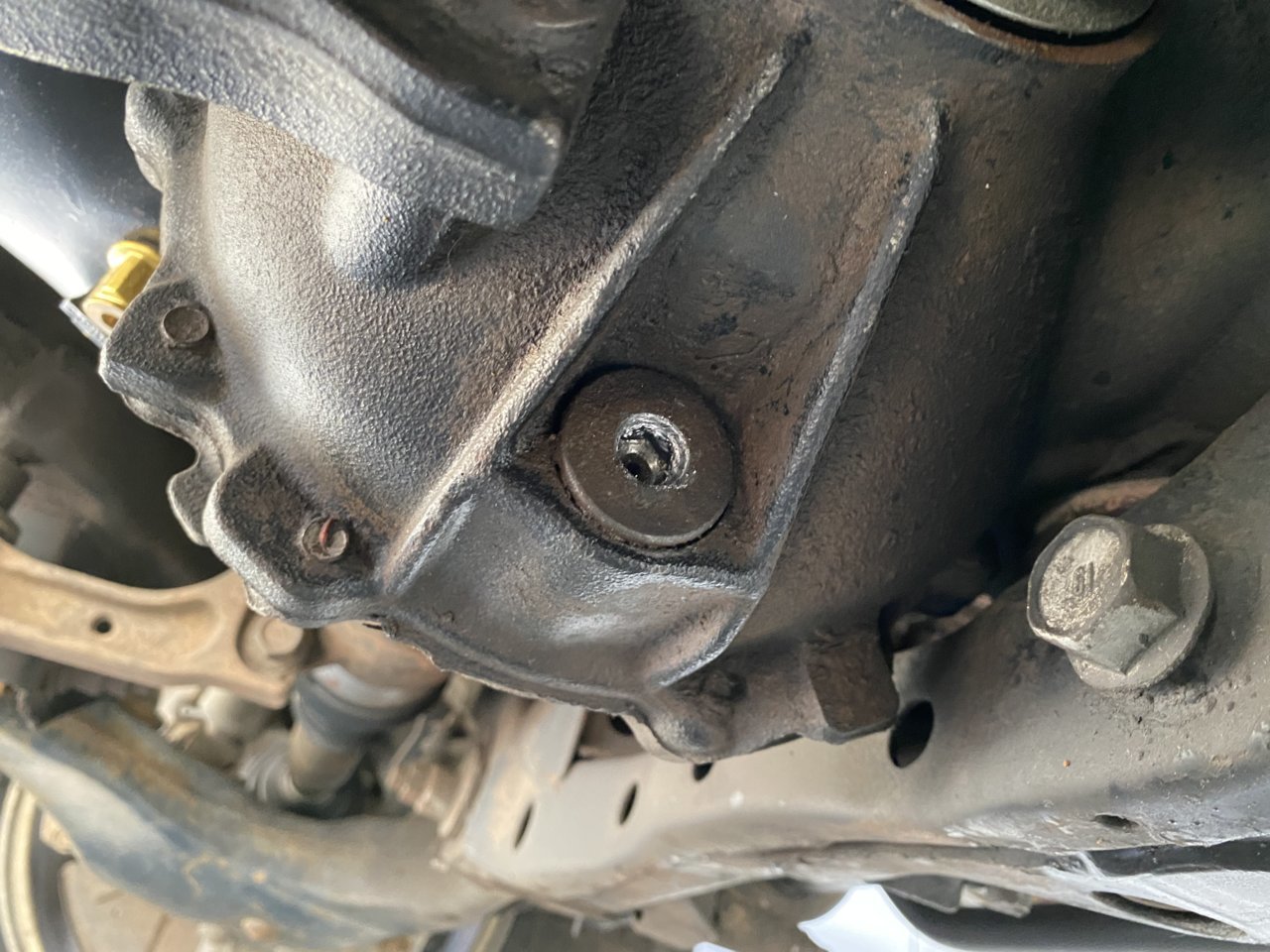

    Here’s what it looks like as of right now

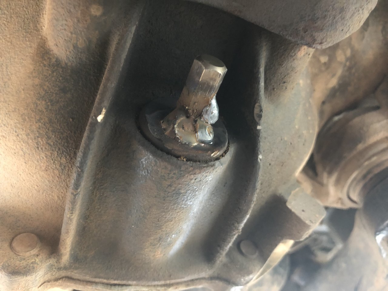

    This is what it will look like right before coming out:

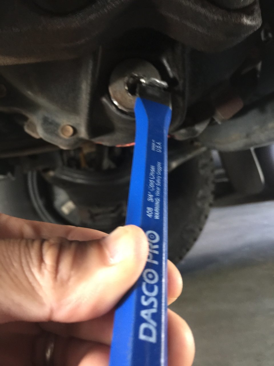

    A cold chisel makes quick work of it too. Cuts right into the plug.

    Nope, the chisel is sharp enough you just hammer it into the plug and it digs into it, loosening the plug. Let me try and find a pic.

  11. Jun 20, 2022 at 1:35 PM
