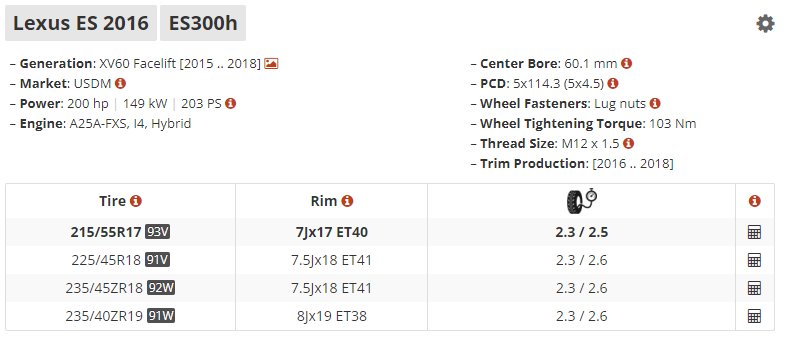

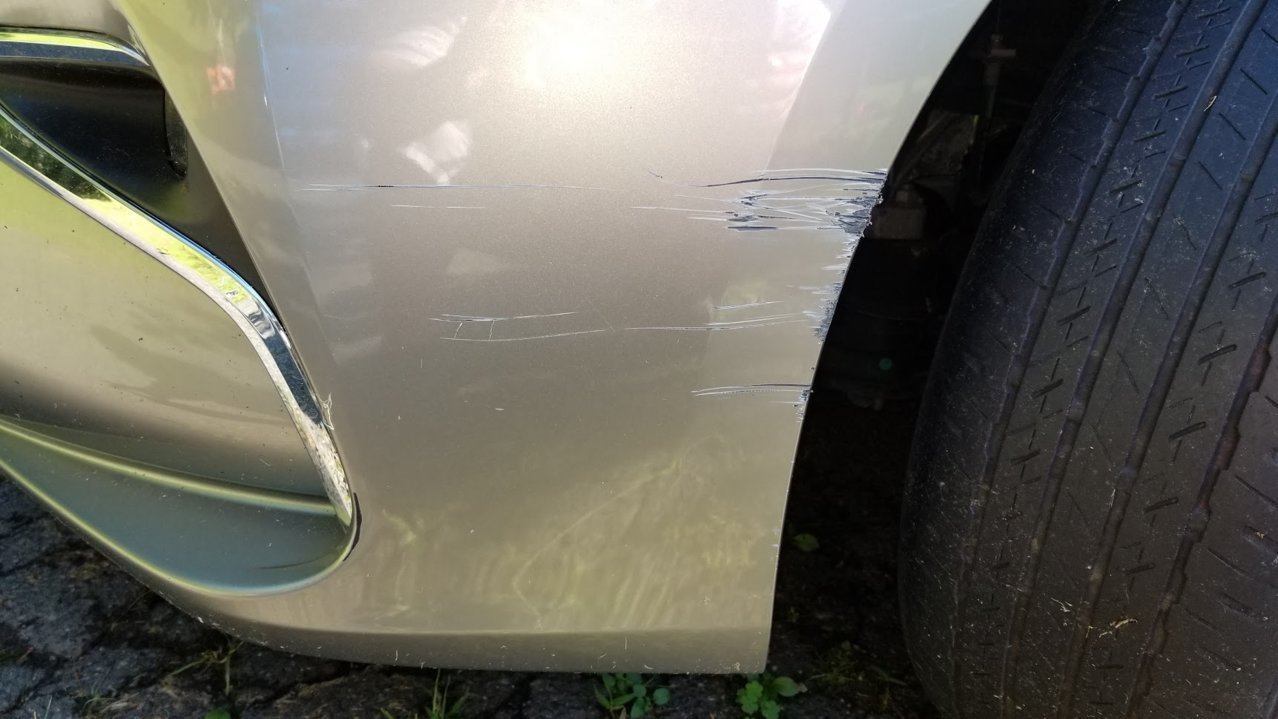

    Ok, so I need some help deciding what new tires and maybe wheels I want for the car. I'm not opposed to going up in size as long as max is a +1. Low profile is definitely in of the question. Spinners maybe not. It's Debs car. I also need to fix some body areas in the plastic fender up front. I can handle that myself easily and might buy a cheap airbrush to play around with doing it.
    DvUDONTSN5pGf01a2BZ7neaKZax_okzYHLr16aw6_1ba14c4213c0a8ff38b8946536bbc9f1dc5ae423.jpg
    It (the gouges) looks worse on film, but the tire looks like this in real life.
    So, all season, touring, passenger, and will even consider higher performance all season. Just need something as close to the stock size as possible.
    Lexus equips the 2016 ES 300h with a 215/55R17 tire.
    GO!
