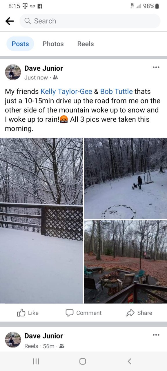

    My pissed off FB post this morning!

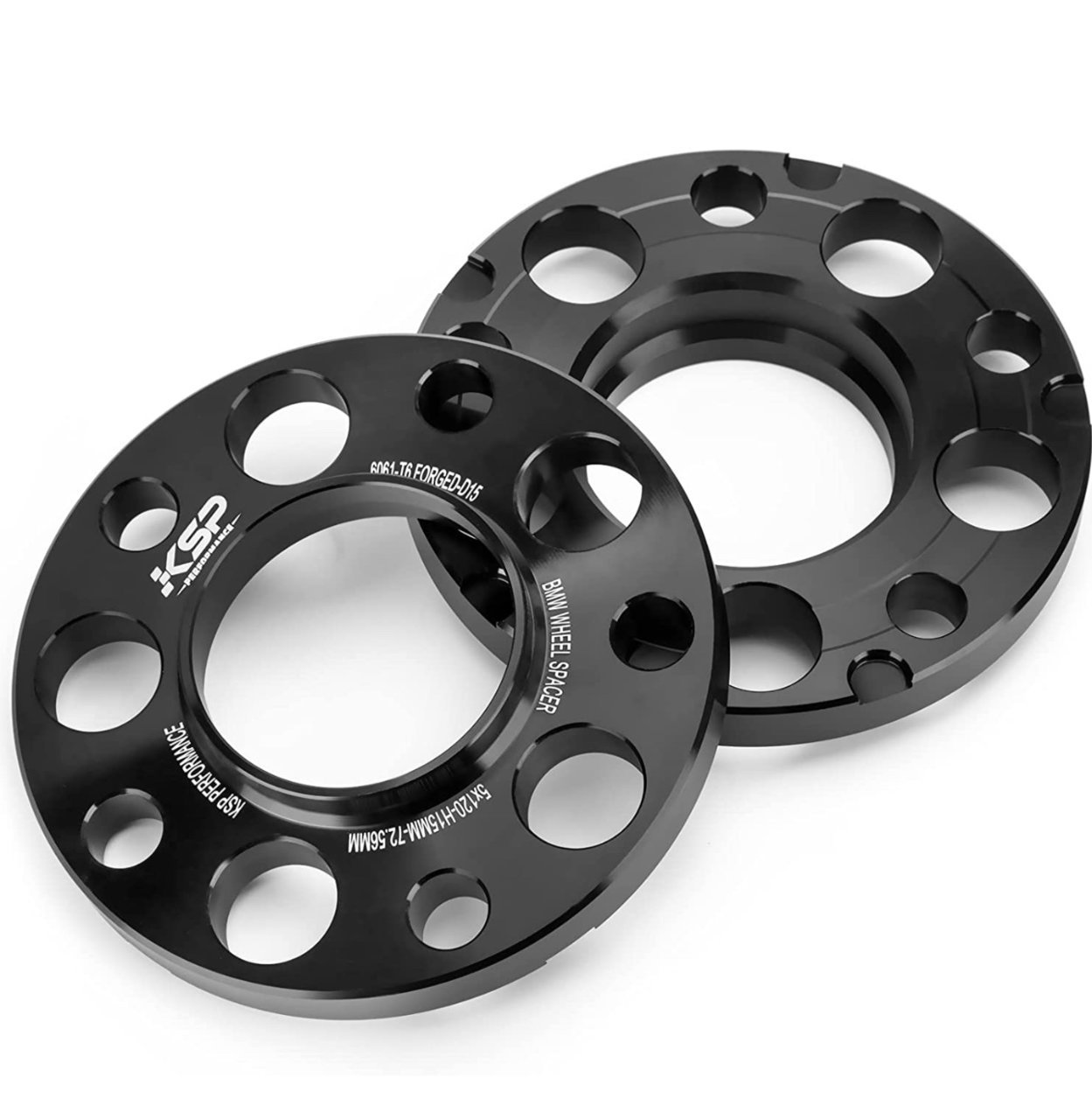

    Im thinking a lathe if you have access to a shop with one… long shot, but probably best bet. If not, I’d just rough cut what you need off with a cutting wheel. Then go back over with a grinder to clean up the remainder and smoothen it out.

    Maybe cut a wood plug to fit in the center and use a hole saw? You could make the plug fit snug, lay it on a board and run a couple screws in a couple of the lug bores til the head is below surface to keep it from spinning? Then clean it up with the grinder or a file.

    Yeah, no access to a lathe unfortunately. I called a few machine shops and they either didn’t call back or don’t really have time/interest in making a few one off parts. Am leaning toward the cut off wheel and just taking my time. The discs I have say they can cut aluminum. Though reading you gotta be careful or the disc may explode cutting aluminum.
    I had not even thought of a hole saw…. That might work, just would need to keep it at a low speed and heat down to ensure the aluminum does not melt. Thanks for the idea.

    Yep, just take your time and try to find a fine tooth one if you can, or maybe even a carbide one would work.

    Aluminum is really easy to cut. You can mostly use wood blades to cut it. I cut tubing, bar stock, and plate with a standard miter saw and table saw using construction blades.

    Lathe job, although I understand that you don't have access to one. Does the auto hobby shop on base have one? There are a few issues that I see from wanting to modify that part, the biggest one is that you need some hard numbers to tell the machinist exactly how much you need removed, a 1/2" difference between 1/2" and 1" is too vague. The other problematic area is that the amount of existing holes in that part makes for a lot of "interrupted" cuts for the cutter and it will make for a weaker part.
    If you can make a good scribe mark around the circumference of the part, a variable speed jig saw could work if you aren't too worried about the appearance of the end result.

    Thanks. I have the difference in measurement since I didn’t say if I meant 1/2” in diameter or 1/2 off the edge lol.
    Only slightly concerned about the integrity of the part but then you look at some coil overs and they only have the spring seat held in place by a c clip type ring.
    I’m not sure if the base has one or not.
    I think I might try hacksaw first or angle grinder with cut off wheels for aluminum. Or take it to a shop in person and see what they say.

    Carbide and lube.
