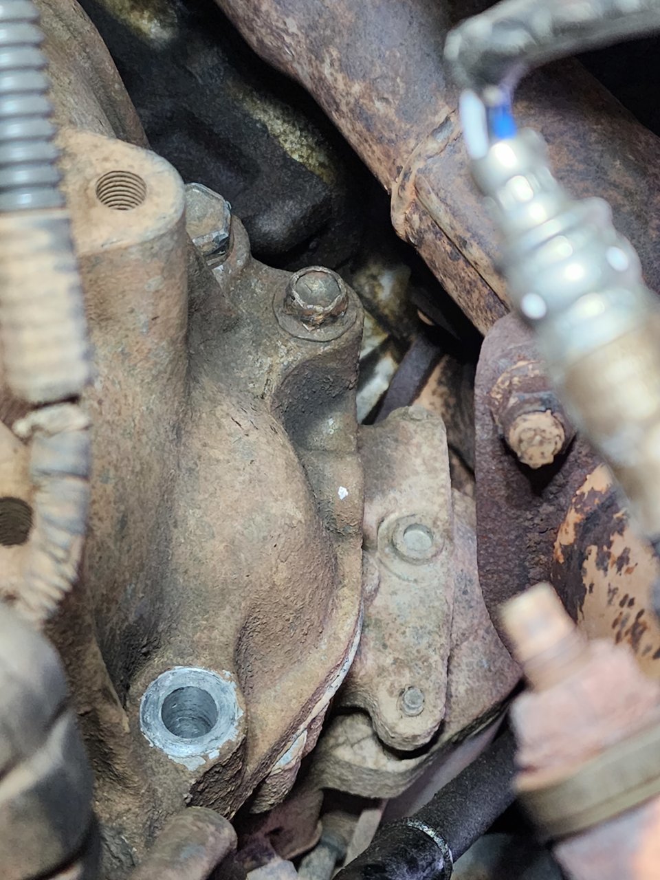

    @Bishop84 you got any ideas?

    I haven’t done one in a few years, I’m pretty sure I do the bolt through the wheel well with a standard ratchet short extension.
    If it’s seized then I would try putting loosen pressure on the bolt then have someone attack the starter with a pry bar to get vibrations on your side. (Unless this is a contract rebuild not a starter replacement)
    I can’t think of anything else. Good luck!

    Get some heat on her! Maybe a benzo torch with a low flame to control the heat placement to the head of bolt only… then hit her with a 1/2” breaker bar. She’ll pop loose.

    Thats what did the brake lines for me, heat, lube, heat, lube, wait all night, heat again, and she popped right loose.

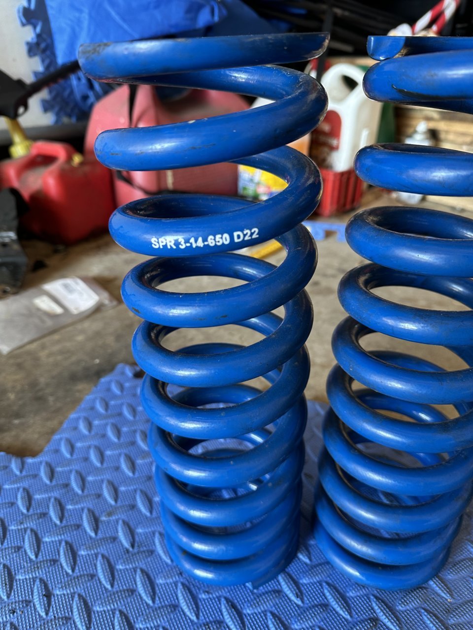

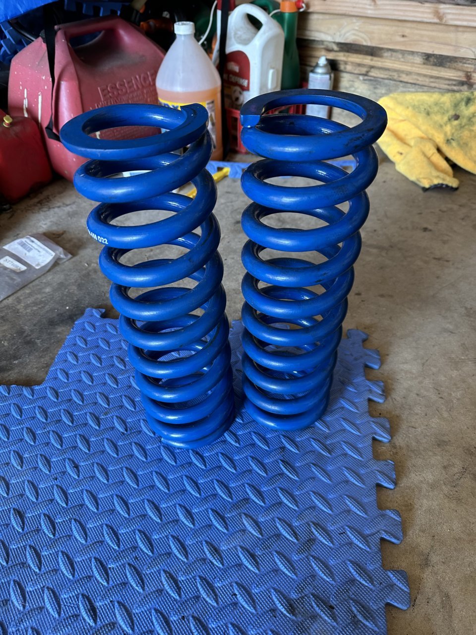

    Also, I now have a set of king 14” 3.0 ID 650# springs for $150 if anyone is interested. Only put about 200 miles on them before I had to swap back.
