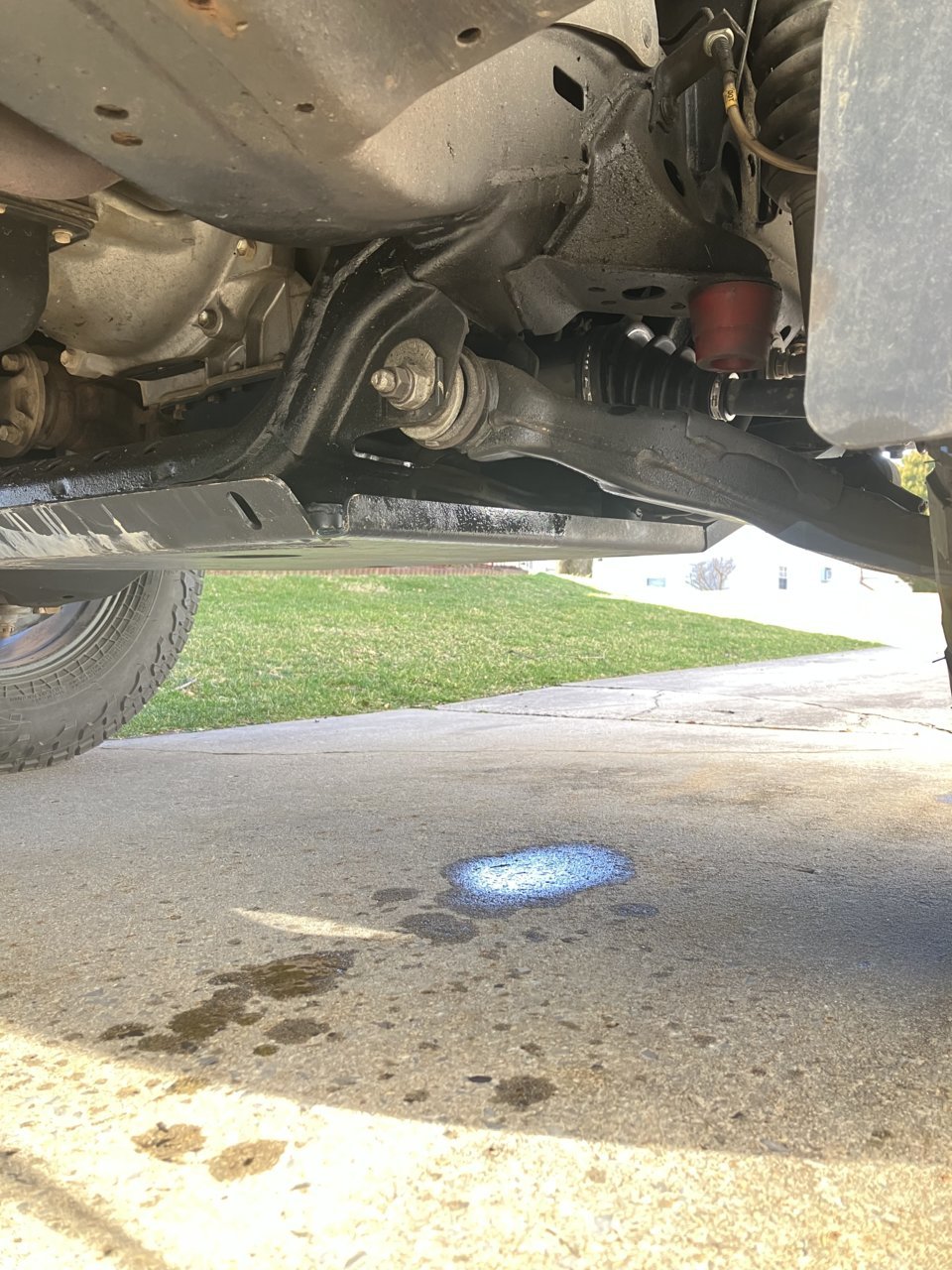

    i backed up slightly aggressively with the wheels turned to the right and stabbed the brake pedal….then i heard a big pop. The c clip must not be in spec because the axle just popped straight out on the passenger side. She started pissing gear oil everywhere. I was able to pop it right back in by hand….but now that i’ve experienced this, the napas will only be an emergency use part. I’m going to rebuild my OEM axles and put them back in.

    Well, fuck. I ran napa for a couple of years with no issues.

    The other set did great until the boots exploded….these ones just felt cheaper when I picked them up.

    Same here. I've had Napa reman axles in my 4runner for about 6years now, so far no issues.

    Have you ever owned a second gen tacoma, 4th gen 4runner or newer? I swear they have the tightest damn tolerances ever and not in a good way lol

    That undercarriage is very clean for a northeast vehicle. You have a new frame?

    No sir, all original metal on this girl. Stripped and hand painted by yours truly a few years back. :anonymous:
