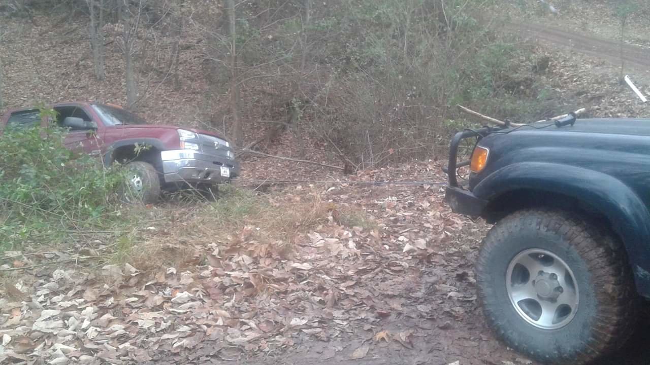

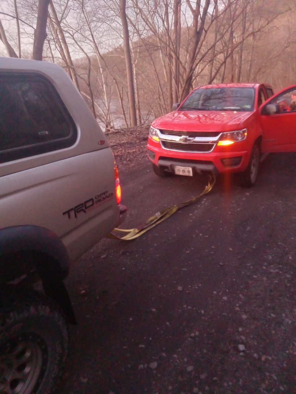

    "Dave's Mountain Chevy Rescue" lol. I did rescue a Ford and a dodge up here also tho.

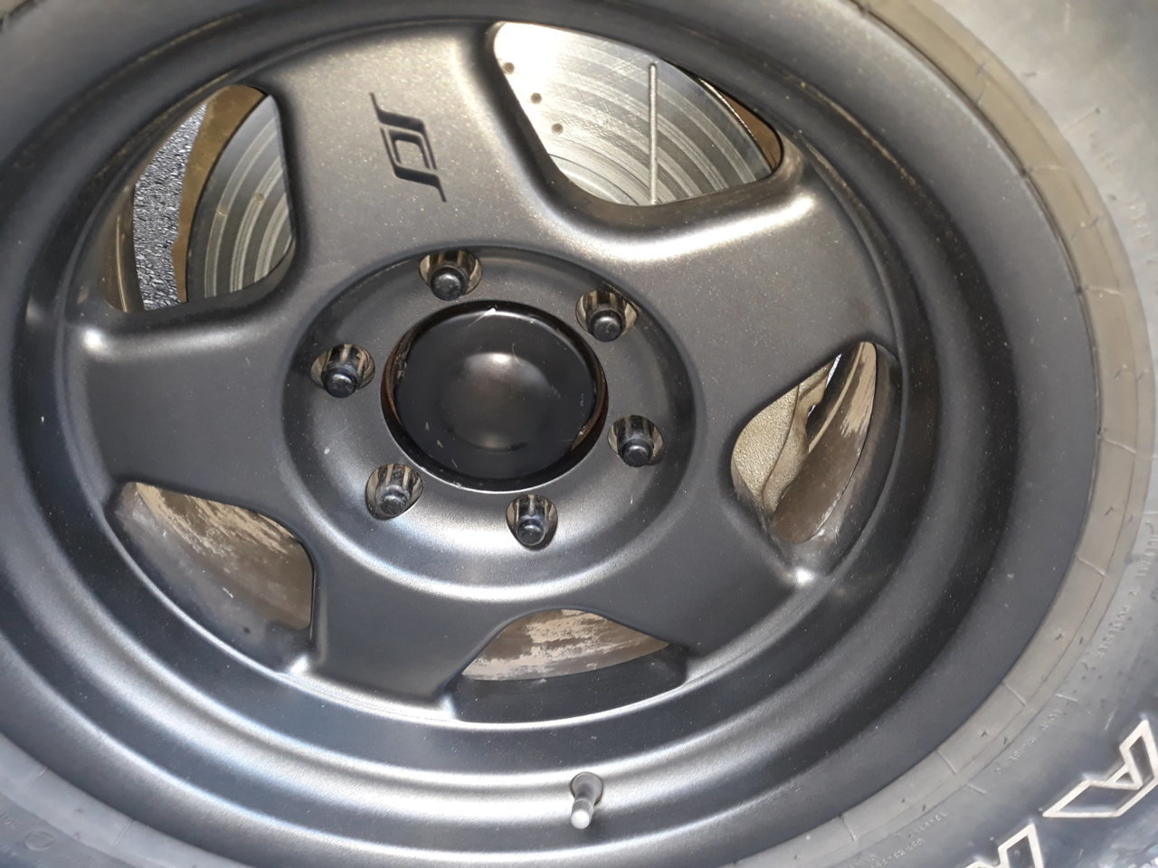

    Wagner TQ is definitely a great choice for pads. They're all I use on my vehicles and when I worked in a shop they were all I used on my customer's vehicles. Because I do all mountain driving I upgraded my 4runner & the wife's 4runner to the 199mm tundra upgrade. Imo the oem sized rotors are too small & thin on these 3rd gen 4runners. These are the rotors that I've had on my 4runner for a few years now. No warping, squealing noise ect...even here on these mountain roads. They seem to disapate the heat very well.

    I installed my 231mm kit with my oem TRD 16" wheels. Those particular wheels come on the sequoia & tundra of that era. @2ndhandTacoman is correct, it's all a direct bolt on with the exception of trimming the backing plate a bit. Also on our first gen Tacomas & 3rd gen 4runners the much larger tundra calibers require more fluid so bigger banjo bolts are required. From my research I've read that some people drill out the oem banjo bolts for more fluid flow. I bought new ss braided brake hoses from Wheelers Offroad, their kit comes with the correct banjo bolts.
