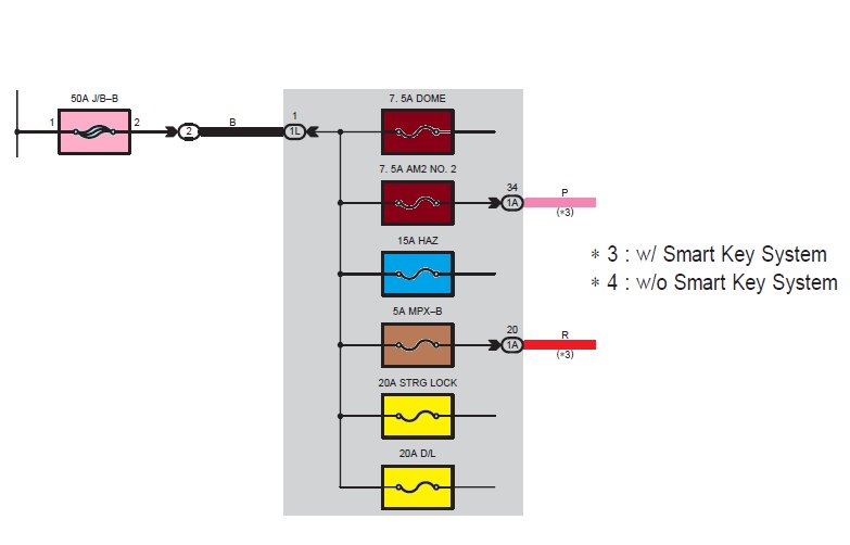

    Hey all, question for you. I think I narrowed down the circuit by pulling out the 50Amp J/B-B fuse under the engine fuse tray. As soon as I did, my draw dropped from roughly 150mA to about 5mA. From what I understand, 5mA while shut down is an ok draw level.
    My question is what is on that circuit? The Toyota manual doesn't actually list the fuse circuits, and my my Google-fu seems to be rusty lately. What does the 50A J/B-B circuit power??

    Here ya go-

    Maybe @caribe makaira can help here

    Are those subsequent fuses in a panel in the cabin, I assume? I'll have to check them fellas for drains
    Also, are you saying I shouldn't pull those fuses?
