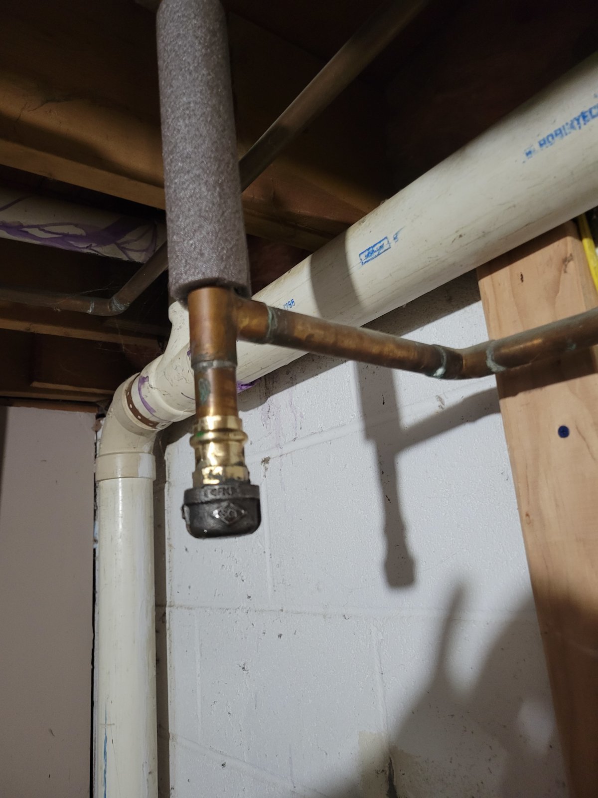

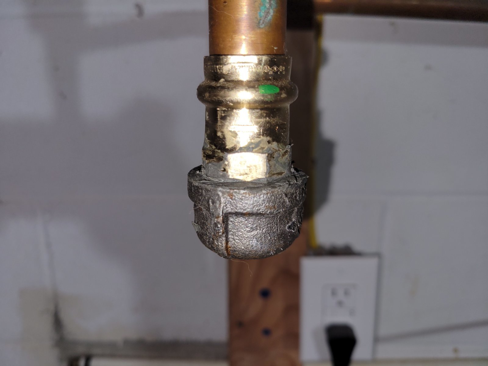

    Hey yall, do we have any plumbers in here? I have a leak. This cap seems to be dripping. The water is coming from between the cap and the brass fitting. Between there also appears to be some sort of gray putty-like goo. I can neither tighten nor loosen the cap, but it leaks. Ideas?

    Stick a wrench on the brass fitting and another on the galvanized cap to remove. Need to hold that pro press fitting on there. Get a new brass cap, the galvanized or iron cap is a dissimilar material and will corrode. Wrap a couple wraps of teflon tape and then a layer of pipe dope. Tighten the same method as removal.
    If you can't remove and install a new cap you're gonna have to cut off that pipe right above the pro press fitting. If you don't want to solder on a cap, you can get a Sharkbite fitting.
    EDIT: It might also be the pro press fitting leaking too.

    Thanks for the great info! Reason I asked is because I was trying to loosen it, had a wrench on the pro press and one on the gal cap, but even then I couldn't get it to budge. I was actually surprised at the metal combo myself, I suppose it chemically welded itself there. And whatever sealing putty they used probably doesn't help.
    As for leak source, I wiped it dry and the water is coming from between the pro press and the gal cap. I'll it it with some flour just to verify, but I may end up needing to cut that pipe. I don't know why our contractor did that...
