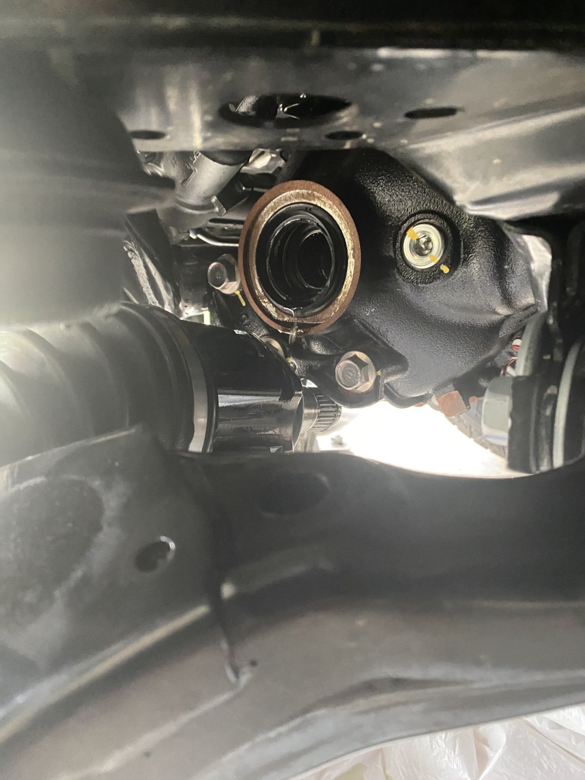

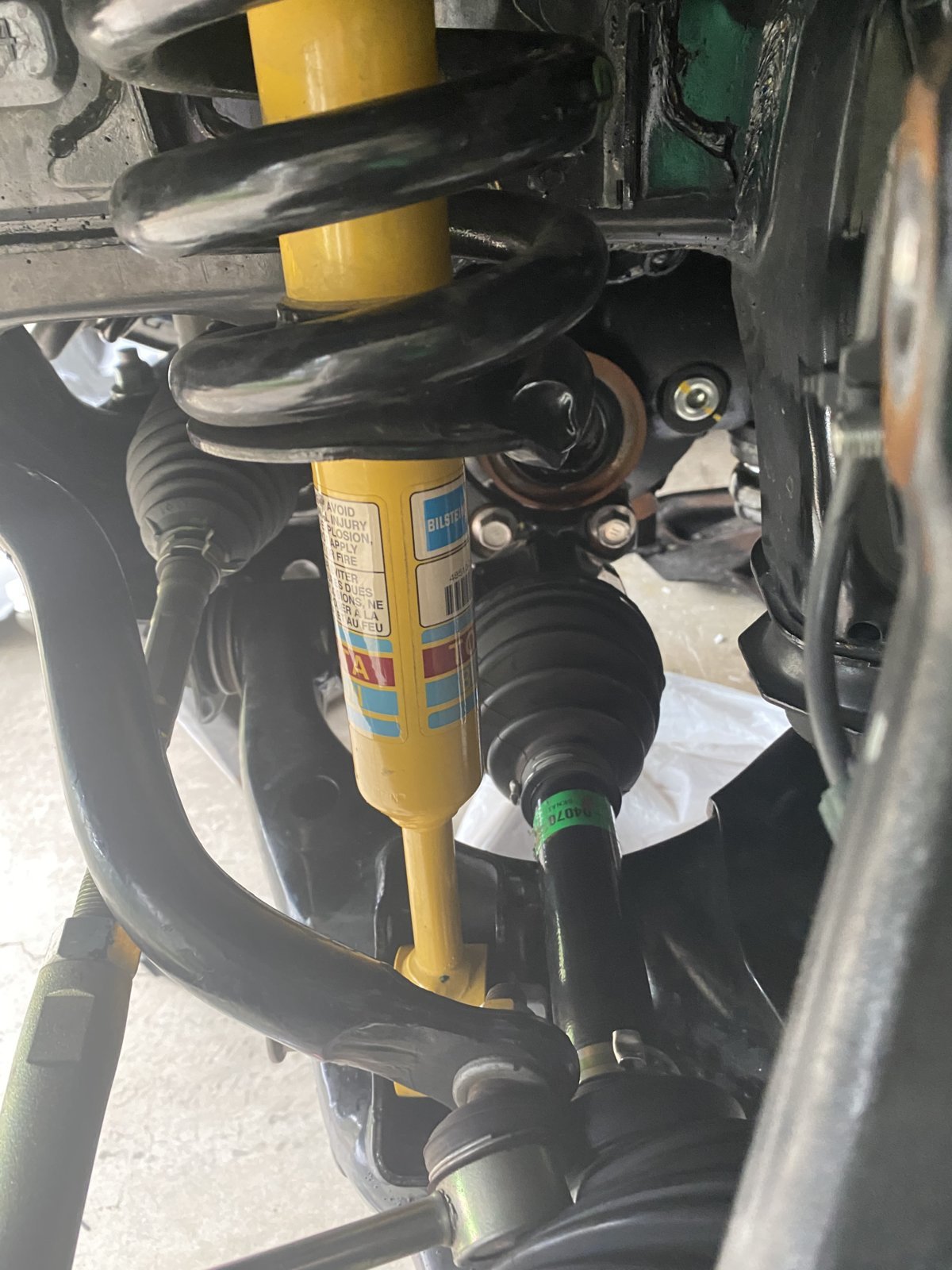

    I’m not sure why you’d need an alignment after replacing it. Maybe a lot of times it happens when changing the shocks.
    I did mine when I was swaping out the suspension. I didn’t remove the axle nut either. Just moved that stuff out of the way. However, it was a pain as you get less room to work.

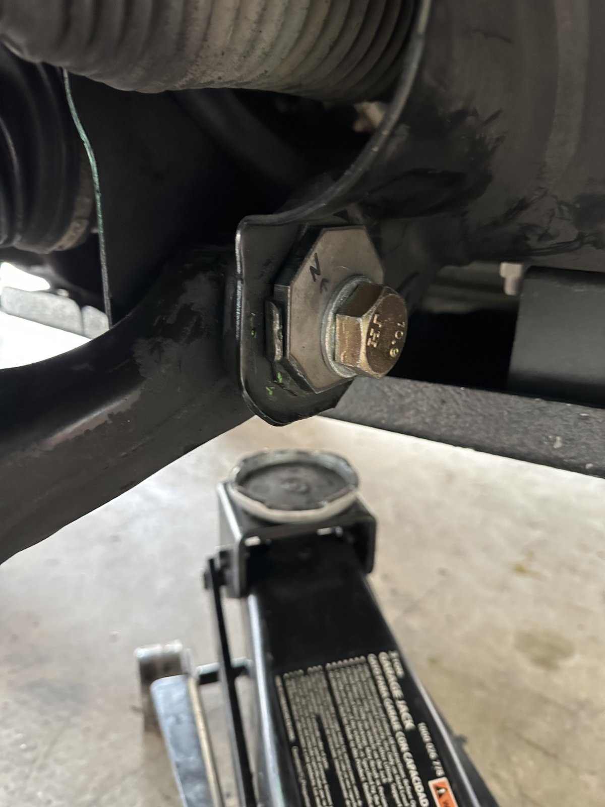

    I had forgotten all about the lower control arm cams :rofl:
    Yep, that’s why you’d need an alignment. If they’re marked and you’re confident, you could be good to go.
    @Taco1004 if you off-road a lot, maybe a good time to upgrade to and octogon and cam tabs-
