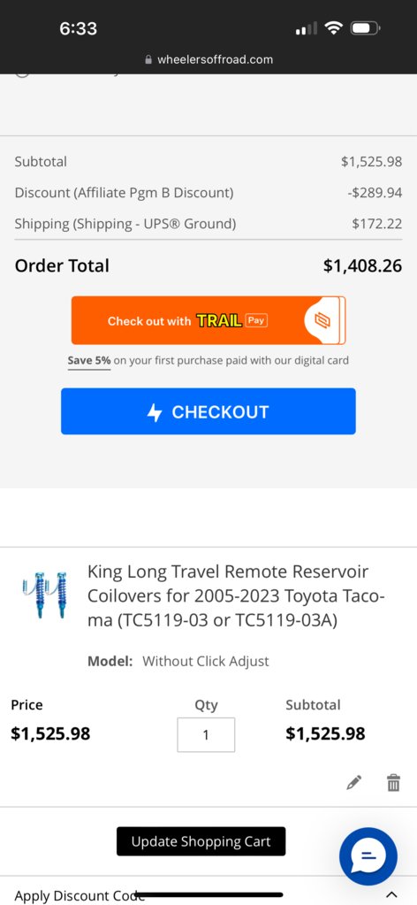

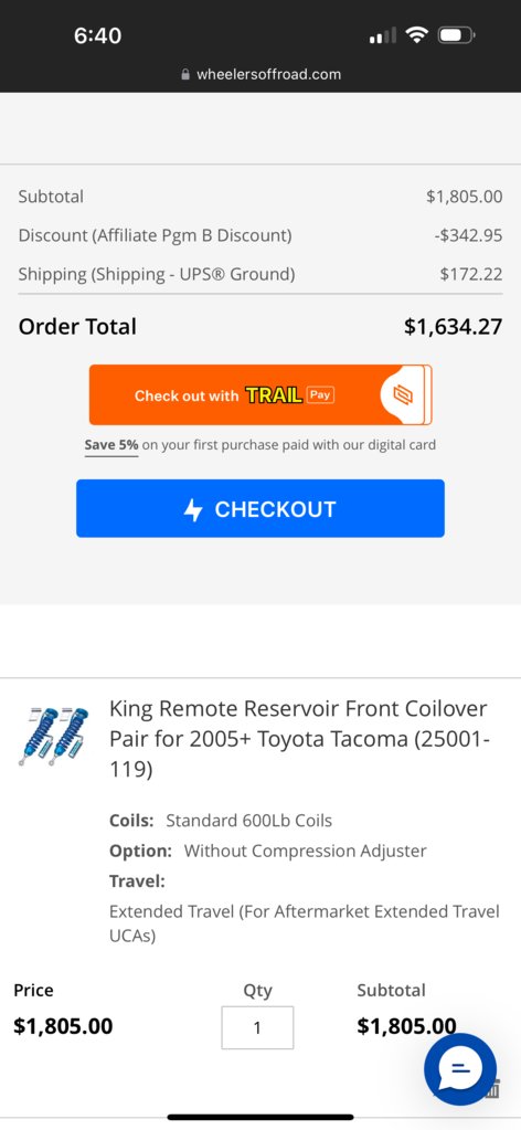

    Might be a good deal, might not but King 2.5s long travel shipped for 1500 or extended travel for 1600 shipped. Both with non adjusters.
    I think they’re normally around 2k so it might be a deal, it might not. The discount code for them is TOYO.

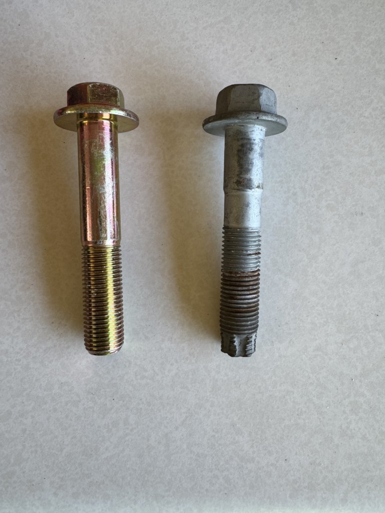

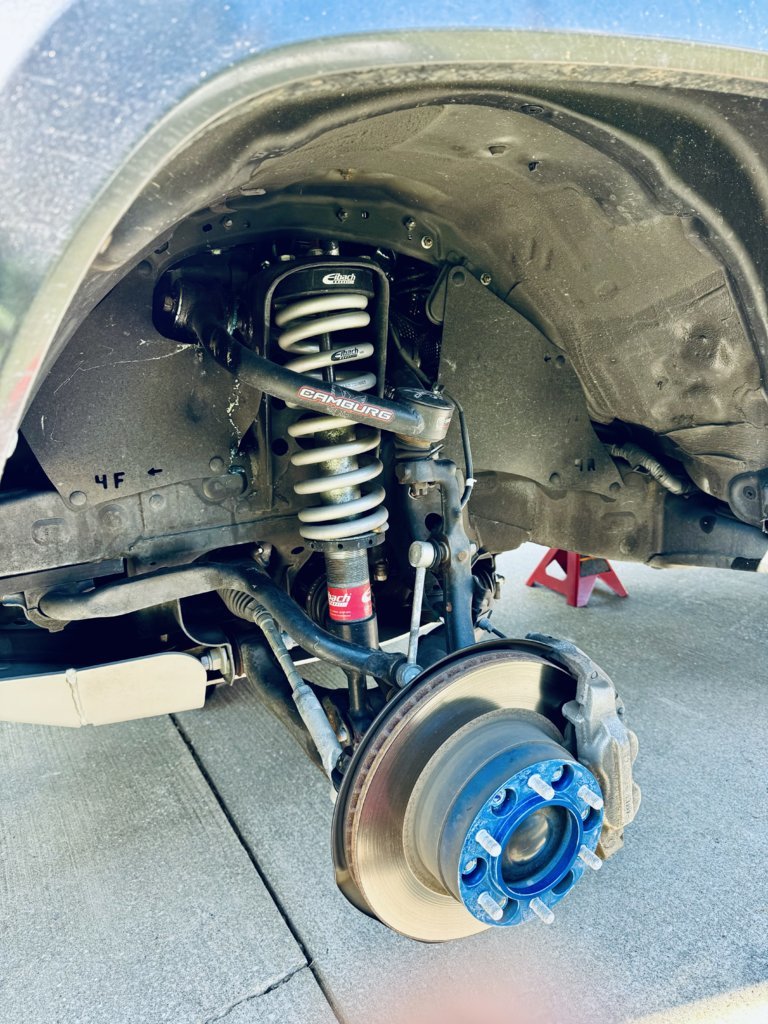

    So, ended up with the day off… woo hoo!! Going to pull the front of the truck apart today. Crank down on every bolt I can find in the steering and suspension and swap those lower shock bolts finally. Throw some grease in the UCA bushings and see if that fixes the clicking noise.

    Well, all done with that job. Seems to be fixed as of now… fingers crossed! Checked every other bolt I could find and all that was really loose was the middle and rear bolts on the TRD skid.
    Took for test ride and only thing I could hear was the annoying brake pad shift when going from forward to reverse and repeating… but the clicking over bumps and while slow turning seems to be gone.

    So far anyway… going to pick the kids up around 330, so we will see how that goes. Thanks again for the bolt find and recommendation!
