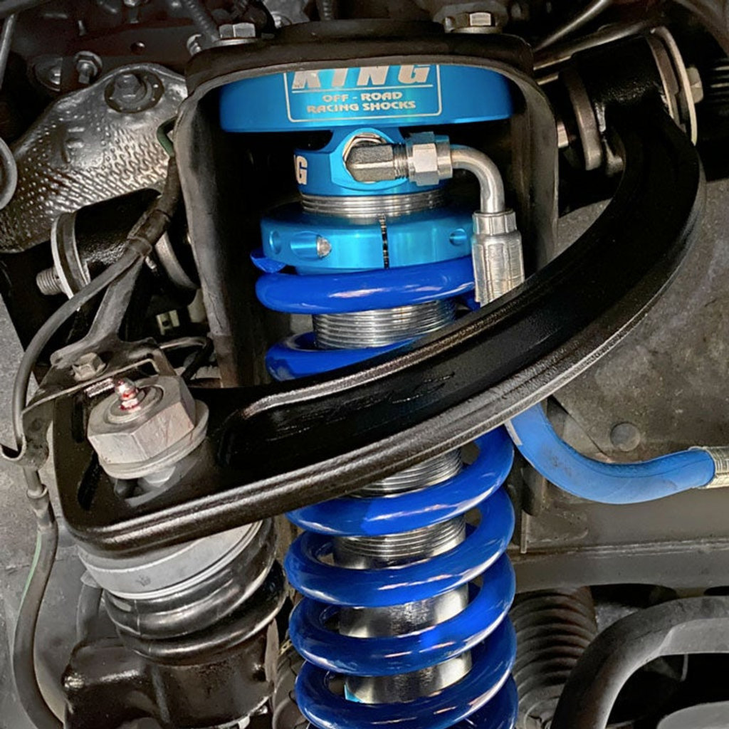

    yea but it’s a bit odd looking with all that silver showing but from what I can tell it’s right. I shared a pic with SPC and looked at other Tacoma installs. I’ve got it torqued to the right amount too

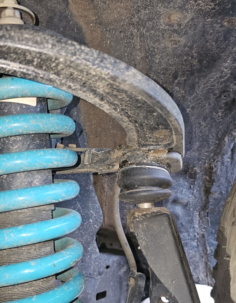

    Eric, you may wanna jack it back up and smack the top of it with a hammer. I did some Google images and o don’t think you’re seared all the way…

    since 2 of you said something I’ll double check.
    I did share a pic with SPC customer service and they didn’t mention it. It’s also seated perfect for the cotter pin to fit. I think the shaft is a little wider or longer than the old style. The one in my pic is the newest.
    if it went higher (or lower) then that hole wouldn’t line up. I should have taken more pics. But I’ll let you two know what I find out.

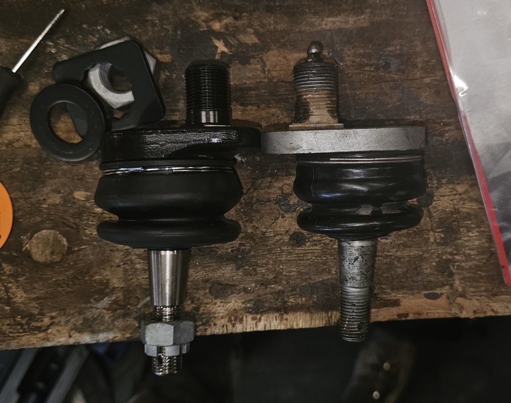

    Saw this post by @UMC and he has a pic of both old and newest. upload_2024-9-19_9-37-44.jpg
    maybe he’ll chime in on his install and if there is a lot of the shaft showing. The pic makes it look like there would be. I’ll try and get a pic of the seat too.

    Yes the shaft is longer on the new ball joint. SPC says they did this intentionally for performance. I have about 500 miles on the new joints and everything looks good feels good.

    Thanks for the response! While installing didn’t think it would go any higher on that but never hurts to check.

    Yeah I thought the same thing especially comparing them side by side so I called spc. I found them to be very helpful and always answer the phone

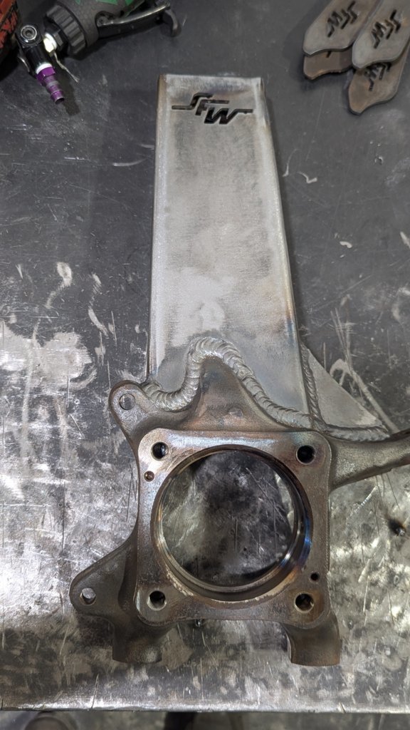

    Spindle gussets that were made by a Fab shop local to me.

    Looks like they did a great job!
