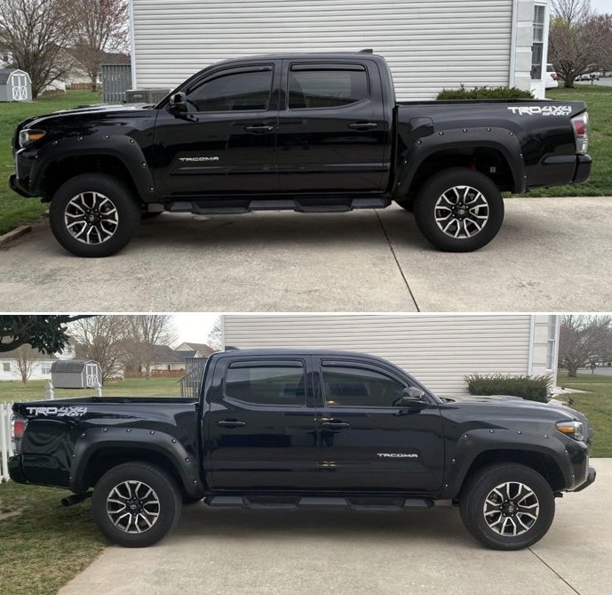

    Rubs a little on full turns. Who knows what to cut?

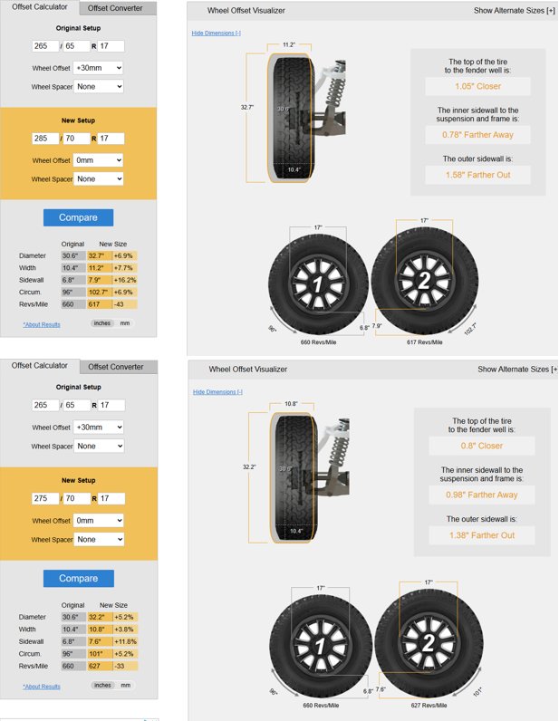

    I wasn't following which is why I ask...what tire size and wheel off-set you got?
    With my TRD Lift 2" Lift, my target is 275/70R17 and zero off-set.

    285/70/17. -12

    Bilstein 6112’s gave me about 2”

    Sorry...it looked stock height.
    I notice clearance on other TRD Tacoma's now that I have the TRD Lift done.
    Yours doesn't look as prominent as mine in comparison.
    Probably because you have the BIG Wheels/Tires.

    this is with 235/85/16’s

    @Backdoc
    Here's what I'm contemplating when it's time for new wheels/tires.

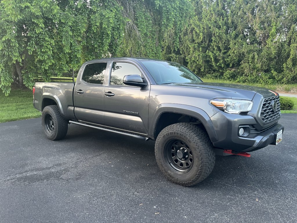

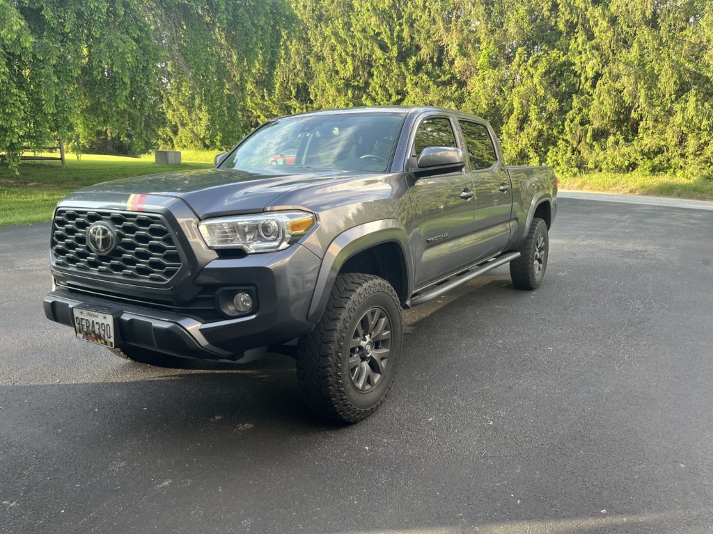

    Mike, she looks amazing!! Makes me really wish I went with the long bed now as I’m drooling over yours!
    As far as the cut goes… best thing to do is go to full lock and crawl under and see where the contact is. Take a wax crayon and mark it. Then do the other side the same. It’s hopefully just a little plastic trimming at the back of the wheel well. I took tiny snips to trim and then a razor knife to make the cuts neat. Dremel with a cutoff wheel will do ok, but they tend to melt as they cut… so you’ll still need to go back with a razor to clean it up.

    DANG!!!
    Those are SKINNIER looking than mine!
    HEY!!!
    I recognize that Grill. :D
    Sooooo, you jumped to 17s...interesting.
    Since mine came with 17s, I figured I stay with and go a little wider/taller with some "Pokey!"
    Granted, I don't wanna do any trimming so I'm leaning towards the 275s because @Dream Weaver has them on his 2018 Sport so I got an idea of what they would look like.
