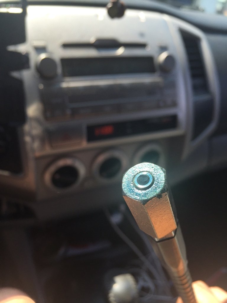

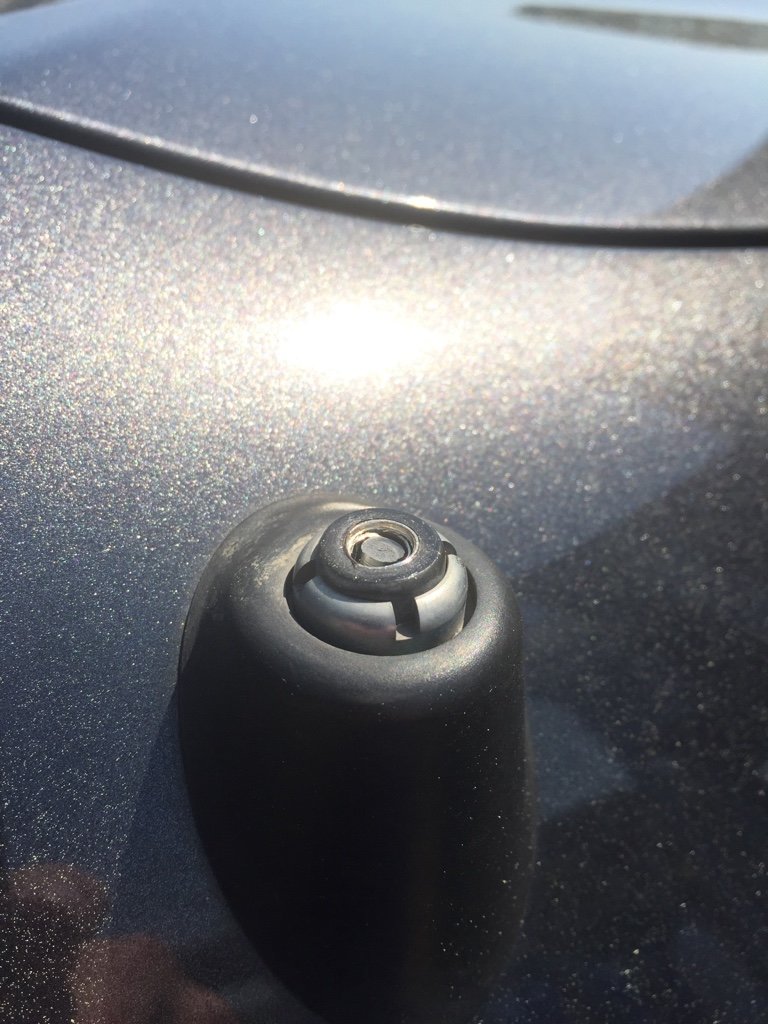

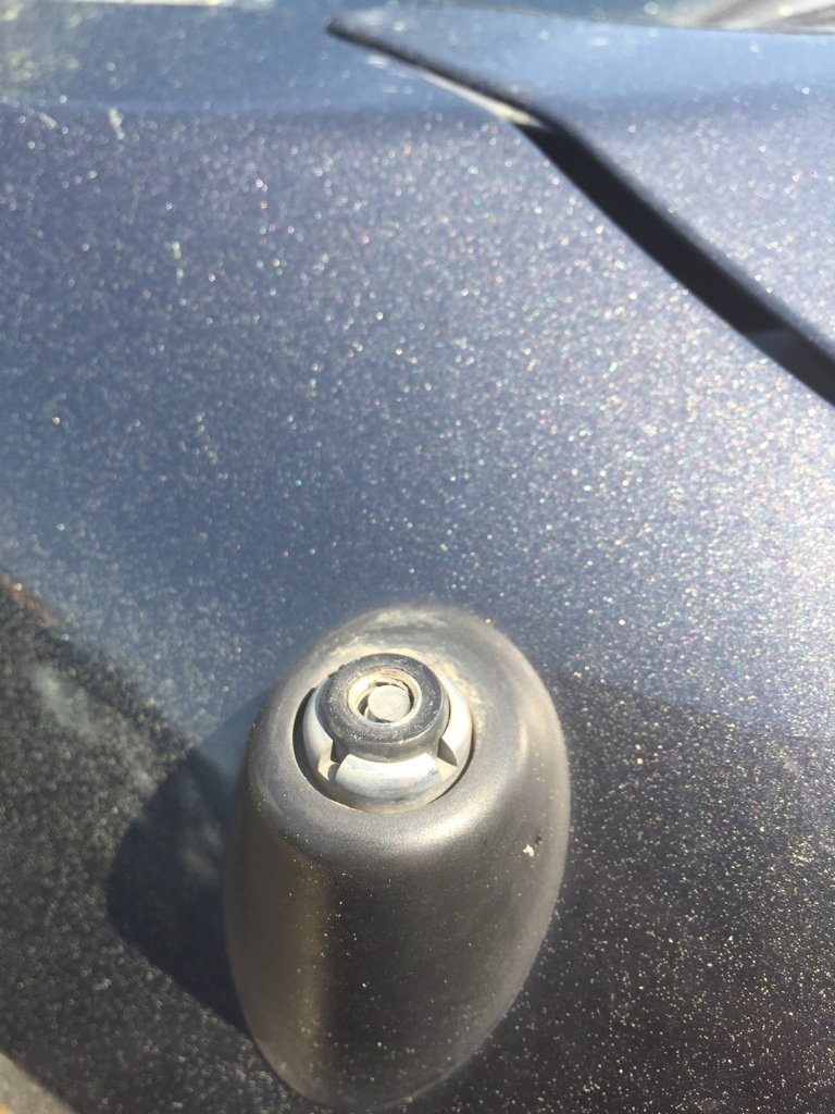

    Antenna delete kit.
    Step one: clip a tree with ur antenna
    Step two: the antenna stud SHOULD break off in the antenna housing.
    And there u go no more antenna.
    I'm pissed. How do I fix this? I'm guessing get a whole new antenna assembly?

    yea, you'll need a new assembly most likely. You can get a flathead screw driver and put it in the slots of the silver nut/ferrule and to unscrew it and get the broken piece out. I had to do it on my old camry and was able to get a stubby one from Autozone and thread it in.

    Drill it out like broken stud on a motor

    Tap into it with one of those bolt puller drill kits

    i was thinking to do that but im afraid if I drill to far ill damage something.

    Go slow and use a shop vac to suck up the shavings as you go
