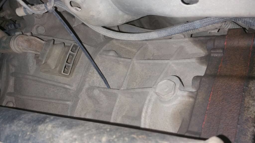

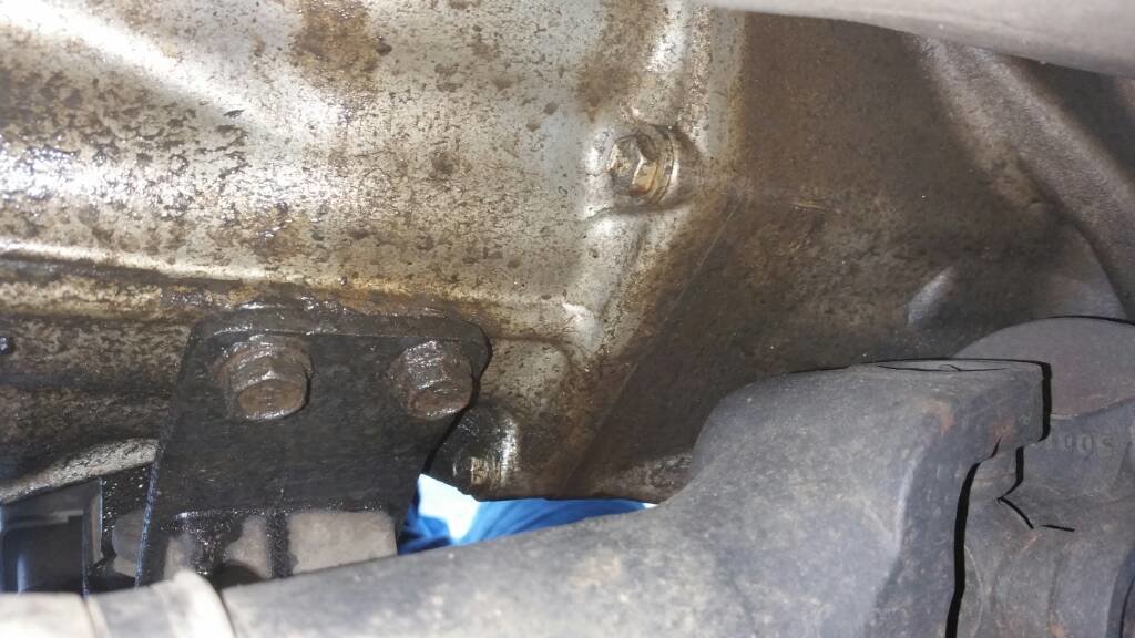

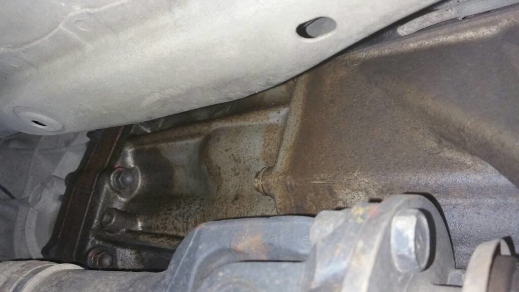

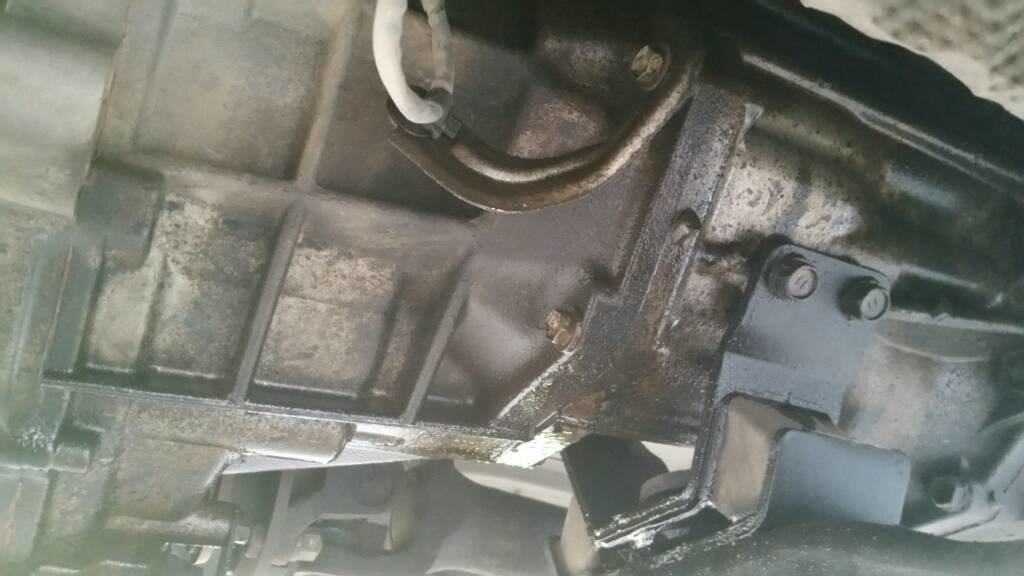

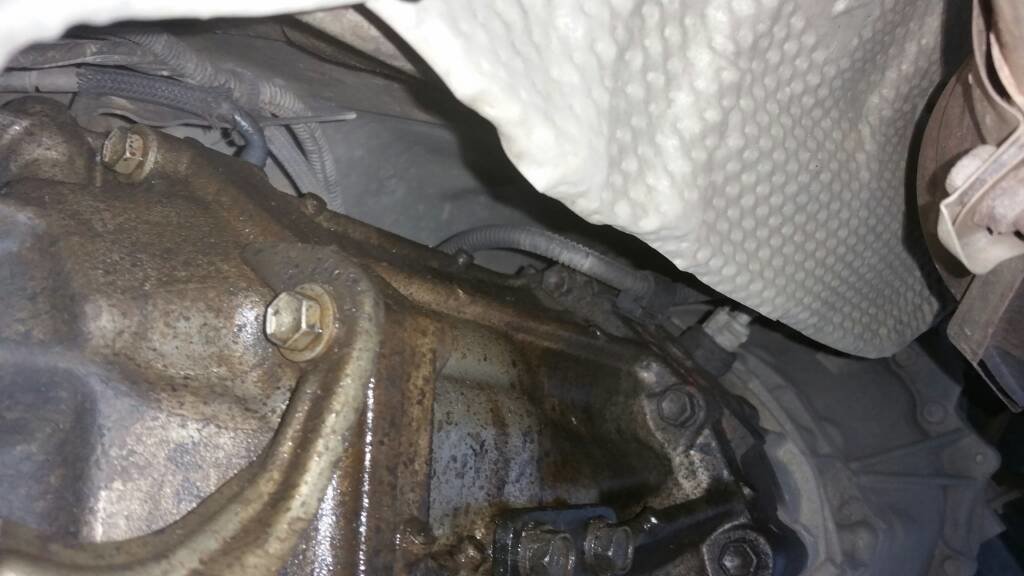

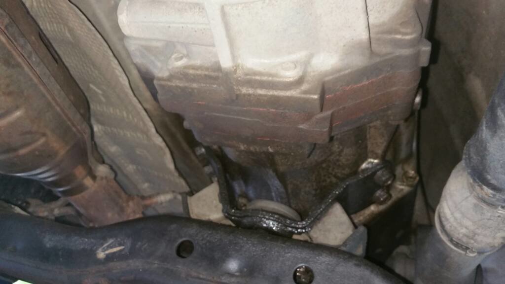

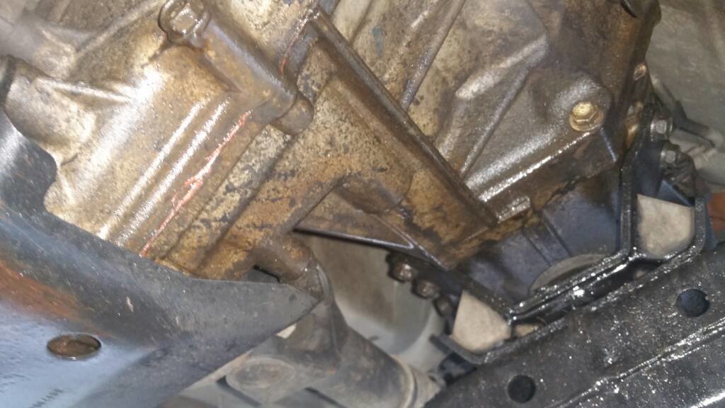

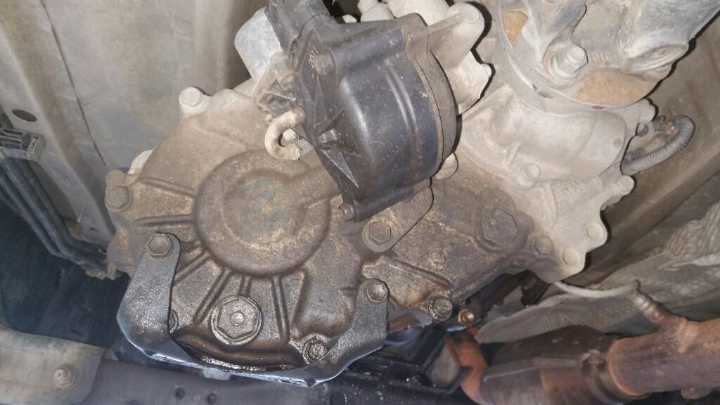

    65k of my driving, PA Coal Mine swamp water, NJ crap water, NC sand pits, and FL Sand marsh have caught up to my seals.
    It's just the back half of the trans and the transfer case. Need to get a handle on this soon. It's not a class III but it is definitely a class II

    I would not be surprised if the shock from the truck falling caused the sensor to fail. First things first, disconnect negative battery terminal for a few minutes, press brake pedal a few times, reconnect battery and start the truck. This will reset computer and should shut the lights off if it is not truly damaged. Another thing to check is to clean the brake rotors and sensor with some brake clean. Sounds stupid but there might be brake dust on the sensor which can cause fault. If the lights come back on, I am willing to bet the sensor is bad. I would replace it and then do the same with the battery.
  17. May 28, 2015 at 1:31 PM
    Mobtown Offroad
    Mobtown Offroad Boss
    Jul 23, 2014
    #134511
    10,797
    Joe
    Harrington, DE
    2002 SR5 4Runner
    Pull the transfer case away from the transmission, clean both well with brake clean and replace the output shaft seal on the trans and the seals on the transfer case. Then reassemble using black RTV.

    Why do you make it sound so easy Lol.
