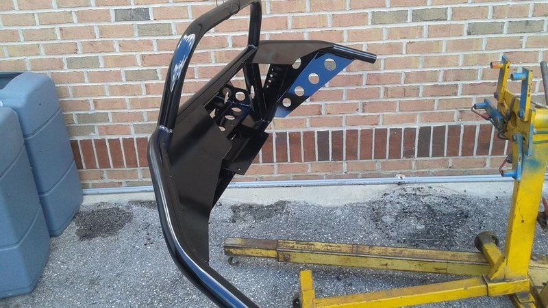

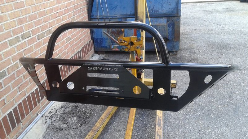

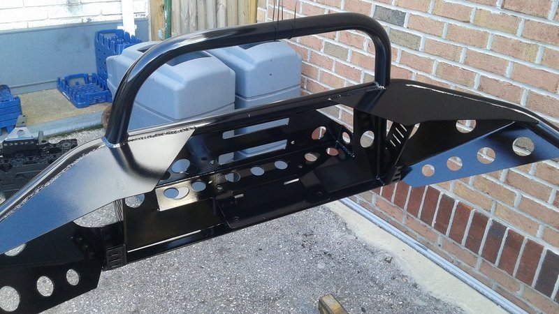

    Finally got around to unwrapping & painting my new bumper today at work. Plan on installing it this fri or sat.
