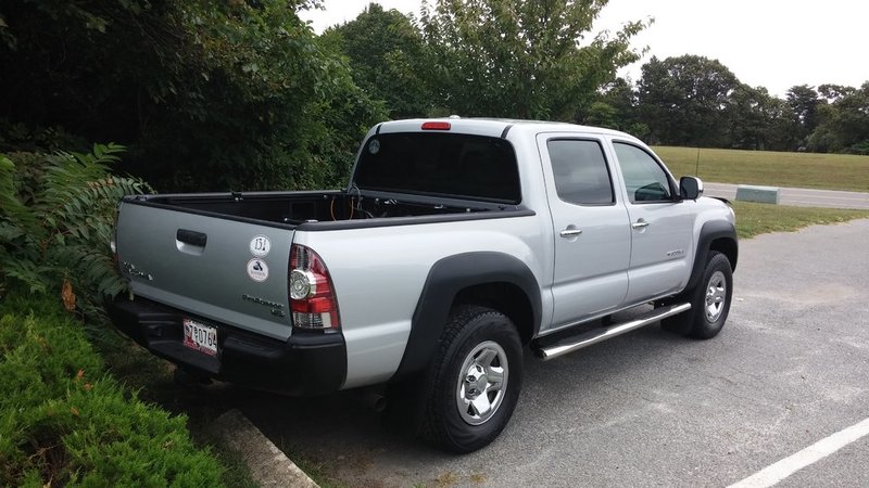

    Hub cap covers over steelies. Hopefully I'll have a set of alloys on in a week or two. If so I'll be selling the steelies with the sensors, lugnuts and these hubcaps with the Geolanders

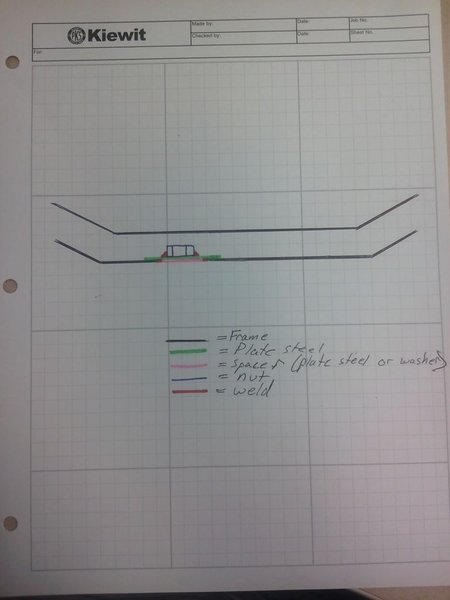

    Finally got around to installing the new Shocks/springs that i bought, rears went in fine with the exception of having to cut the old rusted bolts off, but when i got to the fronts, as i went to unbolt the sway bar brackets, 3 of the 4 weld nuts on the inside of the frame have broken off, so the bolts just spin when trying to turn them in either direction. I would cut the bolts and ditch the sway bar, but the new stuff is just stock replacements, so im a bit wary of just ditching the bar. there is 1 tiny window in witch you can see the nuts, but its far to small to fit any sort of wrench or vice grips/pliers in there.... any suggestions? and no, i wasnt using air tools, and the nuts got soaked in WD 40 for about 4 hours before i tried to unbolt them with a 3/8" x 20" breaker bar.

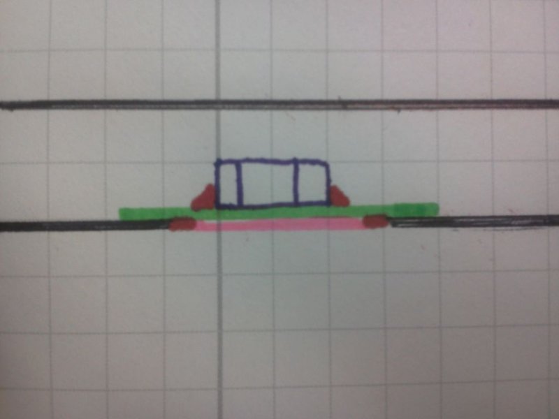

    helped someone fix a similar issue a while back with the welded nuts spinning on the crossmember. solution we used was to cut out a square section right where the nut goes, and weld in a new piece of plate with a new nut welded to it. and instead of two tack welds, we welded the entire 360 degrees of the nut.
    The pink "spacer" is just there to take up the gap of the thickness of the frame steel, which will vary, depending on where you are dealing with along the frame.
