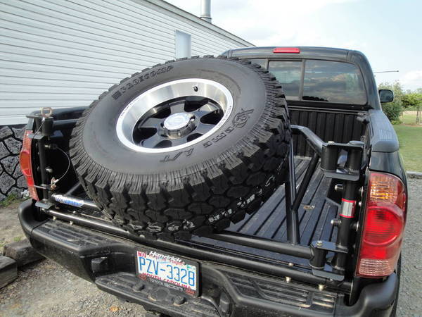

    I like that.... Hmmm mob is it possible to have ha swinging tailgate with a stock rear bumper?

    best option for a tire gate with a stock Tacoma bumper is to lose the tailgate. the factory bumper isn't rigid enough to support a swing gate on its own. if you wanted one that didn't require removing the tailgate, you'd have to make a bumper subframe to mount to, or just cut a couple holes/notches in the bumper and mount it to the frame/hitch.
    remove the tailgate option.

    Can you make the actual tailgate swing with a tire mounted?

    the one in the picture? yes. that's why it has pins on the left side instead of bolts. just pull the pins and it'll swing right out.

    then no, the actual tailgate cannot support a tire on its own.

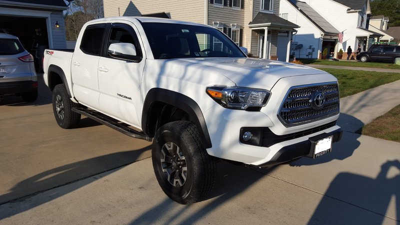

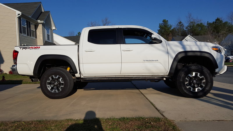

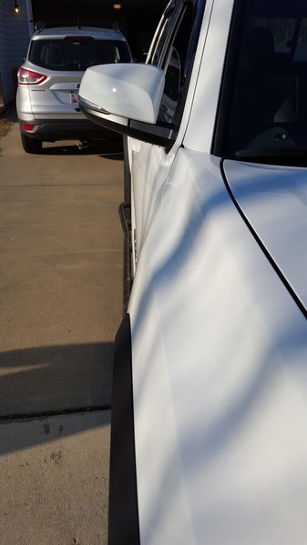

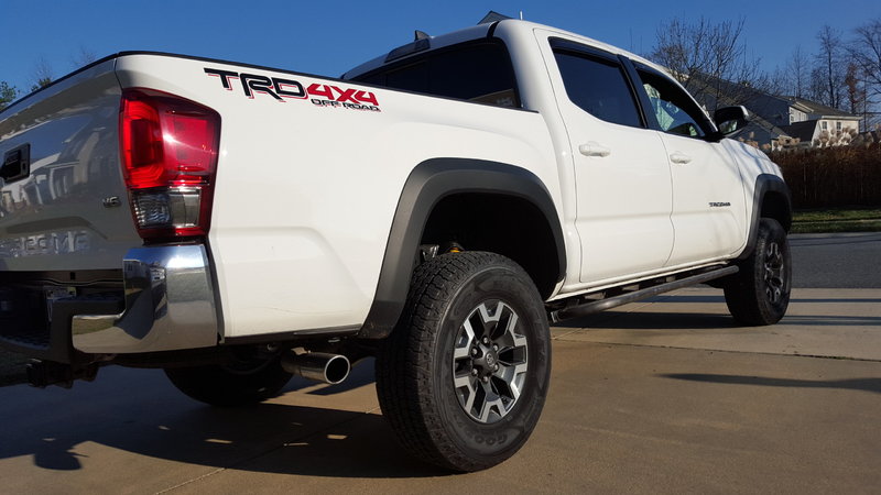

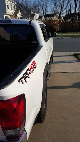

    Is this your new truck or someone's you made sliders for
  18. Dec 5, 2015 at 8:30 PM
    Mobtown Offroad
    Mobtown Offroad Boss
    Jul 23, 2014
    #134511
    10,797
    Joe
    Harrington, DE
    2002 SR5 4Runner
    Sliders for a guy from VA. I don't have new truck money haha. Married in August, closed on our first house 2 days later, baby due next spring. I am searching high and low for a high mileage first gen access cab 4x4. Suggestions? Other than CL.
