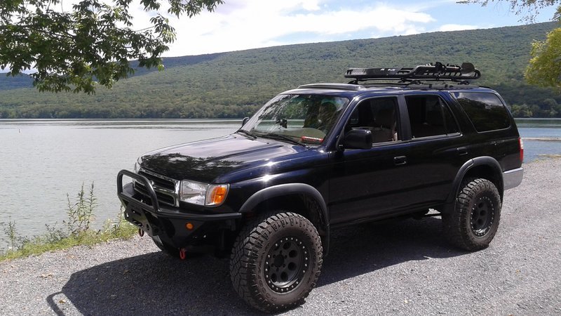

    I installed a 80lb front bumper on my runner couple years after my lift was installed and i noticed no sag. I thought for sure i was gonna have to install heavier front springs but no sag and it still rides nice. I want to install a rear bumper with a swing out tire carrier so heavier rear springs will be needed for that i'm sure.

    I read on T4R that the oem front bumper and bumper support bar on these 3rd gen runners is 50lbs. So i'm only 30lbs heavier than stock.
