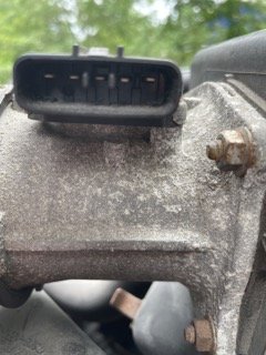

    The MAF on the truck has 5 pins

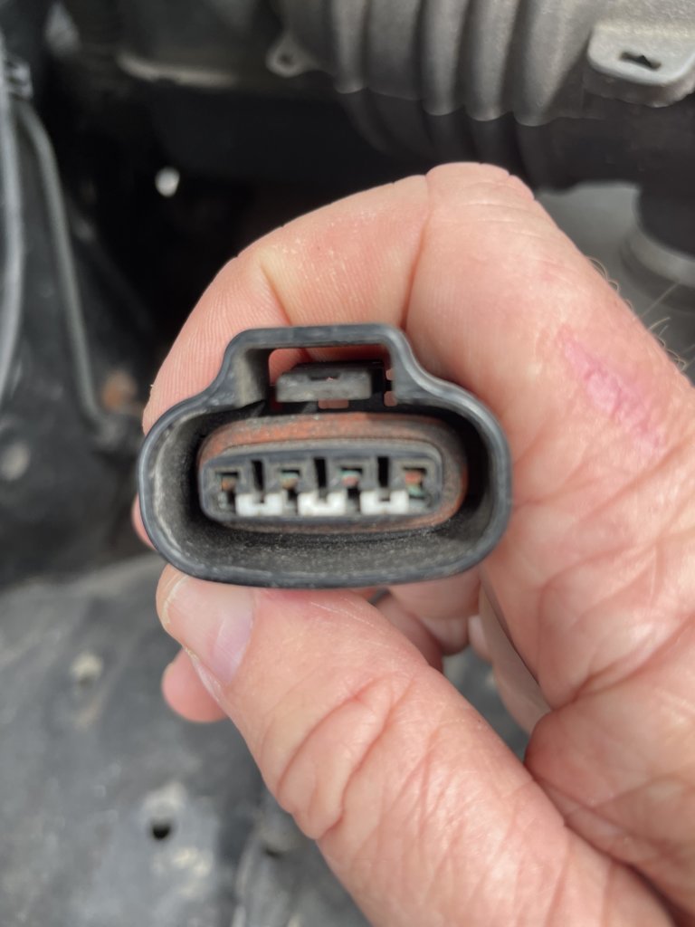

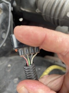

    The harness coming out of the frame has 4 wires and 3 slots (?) for pins.

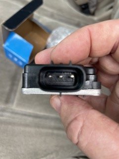

    I bought an older MAF that had 3 pins, and that doesn't fit the 3 slot harness either.
    How did this happen? The frame was replaced by the factory on the recall. Wrong wiring harness, is this not the original engine? What MAF do I need to fit the existing harness?

    If what you say is true.
    Then you have the 2.7L 3RZ-FE Engine.
    It uses a 5 wire MAF. (As does all 3 of the engines that were available in a 2001 model truck)
    Maybe your engine is from an earlier year truck? I'd have to look back in the diagrams and find out.
    But the plug you show is not for the MAF.

    Also, can you tell me what the wire colors are on that plug?
    It's hard to tell by the picture.

    1995-1996 used a 3 wire MAF sensor.
    Which is likely the one you bought that doesn't fit.

    The 4 wire plug wires are: Red with a white stripe, Green with a black stripe, blue with a white stripe, and white with a black stripe.

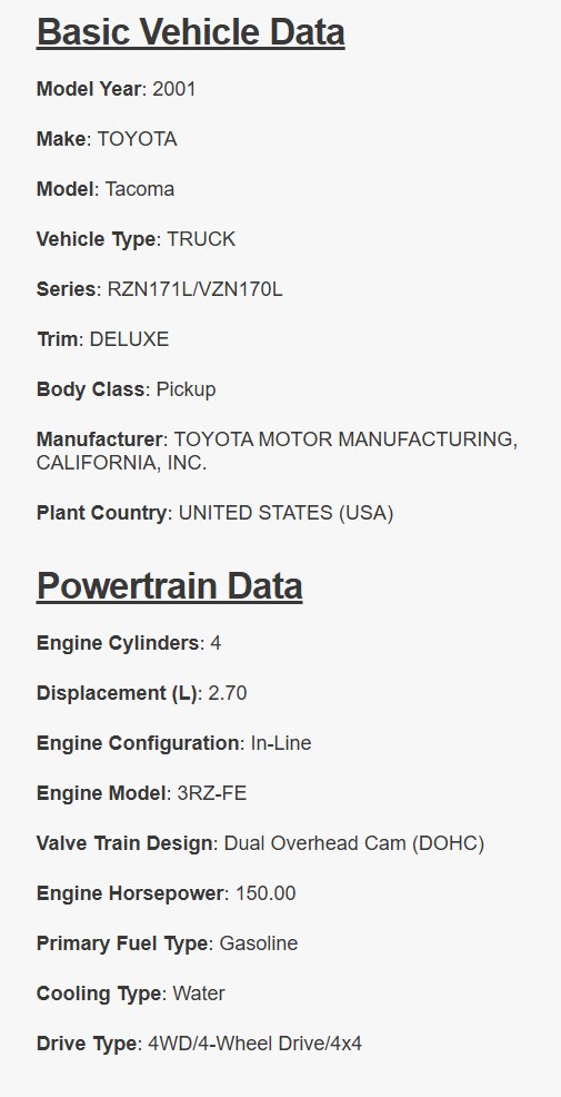

    VIN is 5TEWM72N81Z875344
    Is there a database where I can check original engine info?

  7. Jul 17, 2025 at 3:11 PM
    TnShooter
    TnShooter The TacomaWorld Stray
    Sep 2, 2010
    #42625
    21,194
    Deogee
    07' TRD Off-Road, Auto
    STOCK
    You can make an account on Toyota and add your VIN.
    Google " Toyota owners" and it will take you right to the page.
    You need an Email address to confirm registration.
    It's free...

  9. Jul 17, 2025 at 3:32 PM
    TnShooter
    Sep 2, 2010
    #42625
    21,194
    Deogee
    STOCK
    Think I found it.

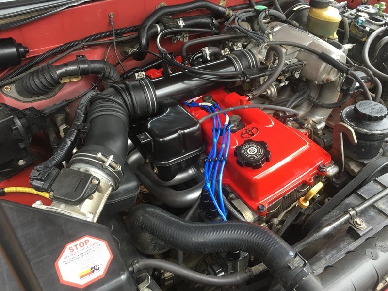

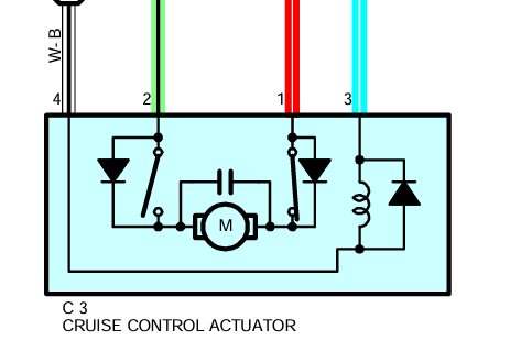

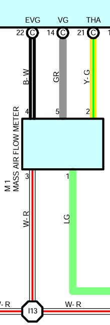

    I found this pic of my engine. Looks like the harness goes along side the air intake and goes down. I'll go out and dig around that area.
    The yellow harness in the lower left is the cruise control I misidentified.
    -Bruce
  13. Jul 18, 2025 at 9:34 AM
    TnShooter
    Sep 2, 2010
    #42625
    21,194
    Deogee
    STOCK

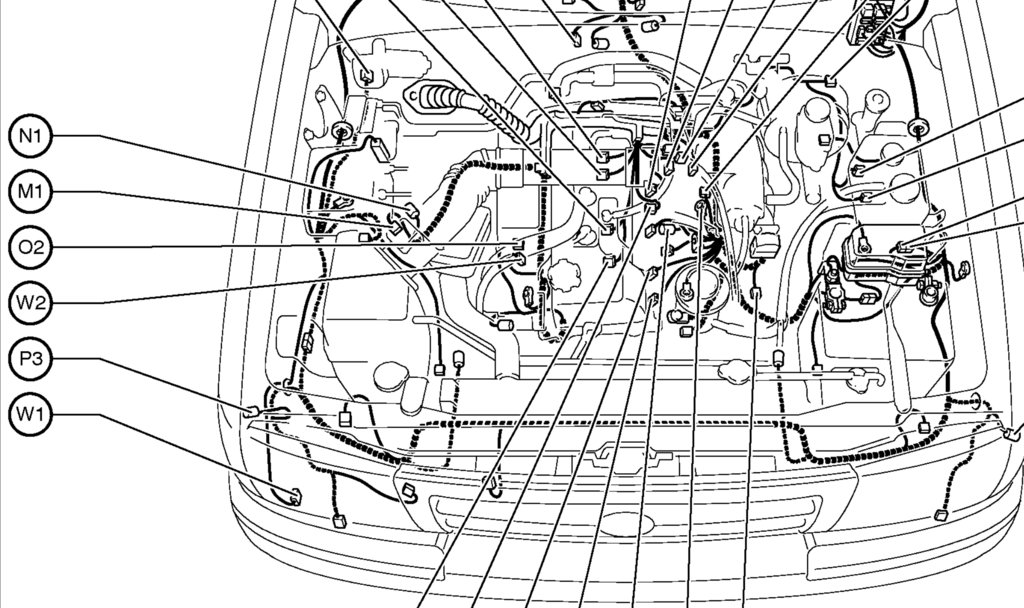

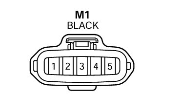

    M1 is the MAF.
    It looks like it comes up under the air intake tube.
    Maybe the harness fell down along side of the passenger side of the engine?
    Maybe the diagram will help?

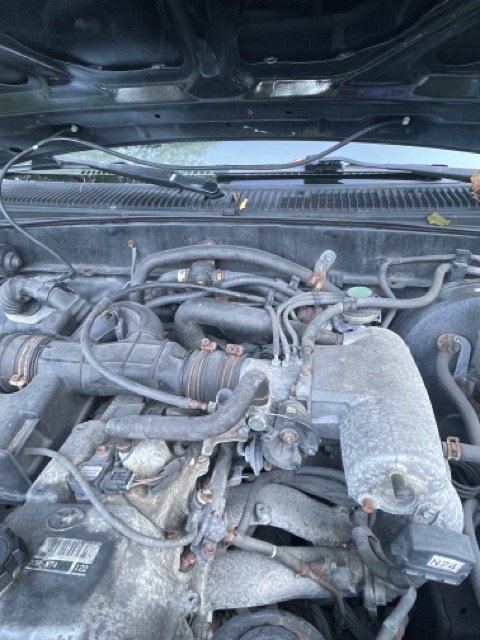

    Dug around and found it!! The kids (at my vocational school) had replaced the manifold and had unplugged it for some reason and draped it across the other way and tucked it under something. See why I missed it? (conduit running under the coolant valve for the heater)
    TnShooter likes this.
