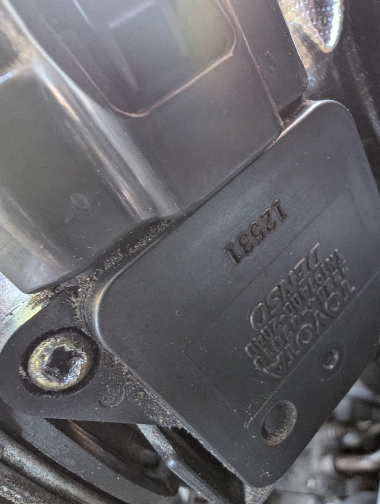

    Here are the photos showing what the screws look like. I did order a stripped screw removal kit and I do have a dremel let me know what you guys suggest.

    OP one screw doesn’t look bad. Hit em with penetrating oil overnight, clean em up and try a proper JIS ( Japanese industrial standard) screwdriver. Then if the stripped one doesn’t come out try the dremel method before the screw extractor. But really try to cut the slot in the middle of the screw
