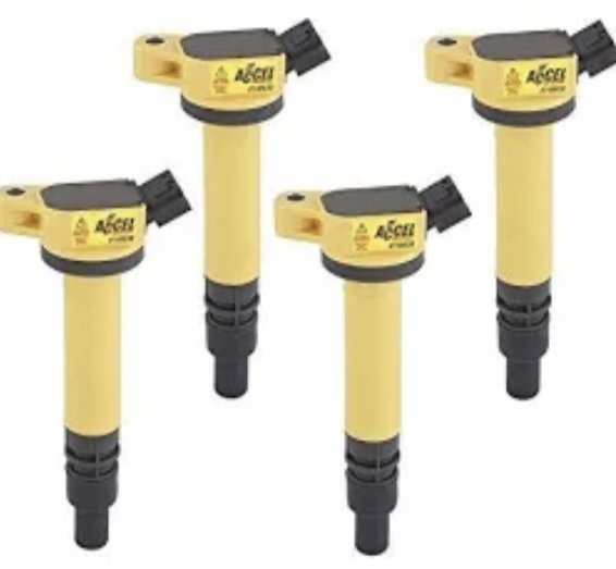

    #16.5. Buy new aftermarket ignition coils like these or something similar8989B63D-96B5-408C-BC24-744A1EA3D7C7.jpgJust do it
