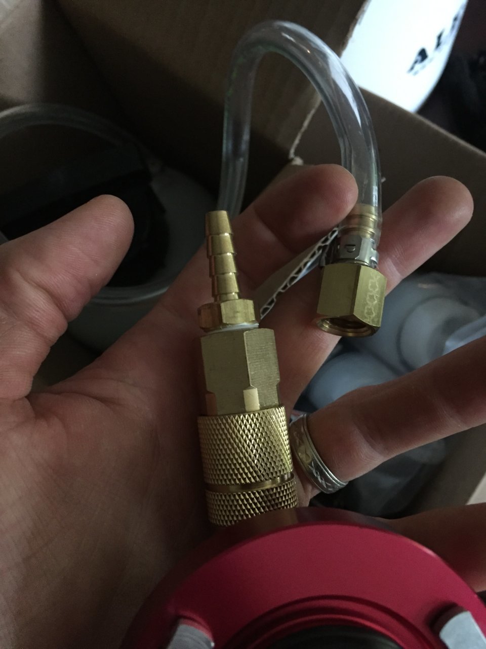

    I have the Sport but this device makes my brakes a breeze to bleed

    Amazon. Had to buy the part that fits on the MC separately, also had to get a double male adapter to join it to the hose on the tank part.
    Double male adapter fixes this problem:

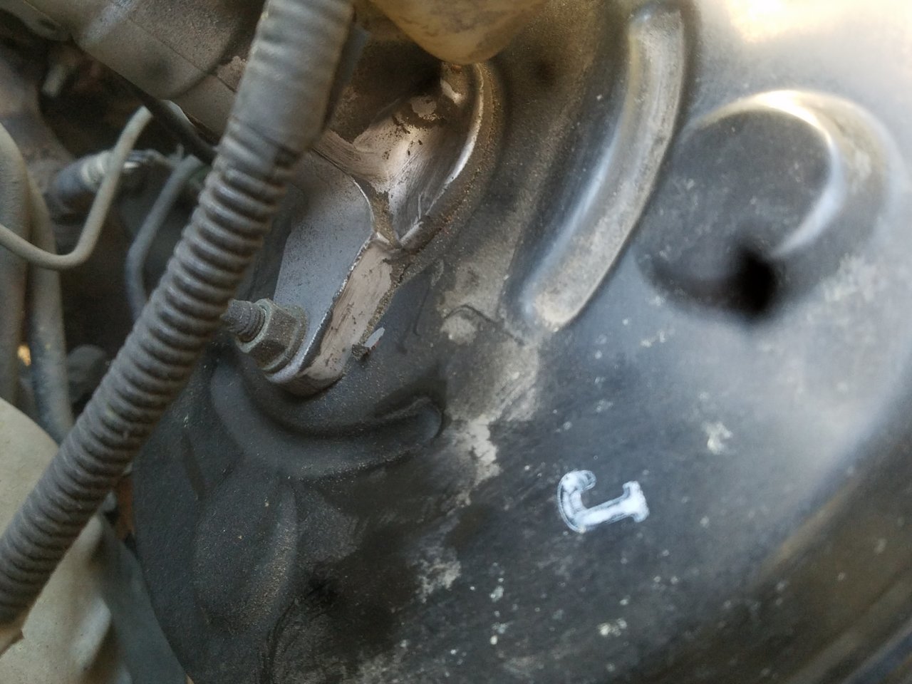

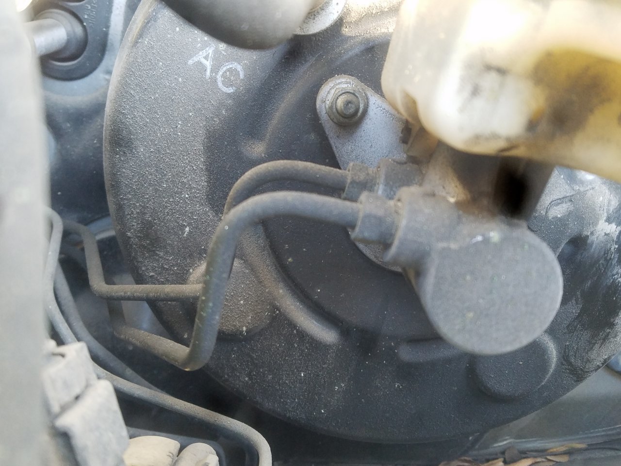

    I hope i chose the right thread for this if not I'm sorry. I just didn't want to start a new thread. I'm new to this forum so please bear with me!
    I have 2009 Tacoma Pre-Runner Sr5 V6 4.0L with 95,000 Miles. I'm currently in the process of doing as much scheduled maintenance as possible and i came across this:
    I'm going to clean my entire engine bay soon which includes removing all this gunk. However, is this something i should be concerned about? I don't notice any problems with my brakes, but still felt the need to ask more experienced Tacoma owners. Any and all help would be greatly appreciated.

    When surfaces get any amount of oil/fluid on them, they get what's called "accumulation" meaning debris sticks to them. Fluid can get on surfaces by over filling or seeping. What I see looks like accumulation caused by overfill in the past.
    My advice would be to clean all the surfaces in the engine bay as best you can and then monitor for leaks. Check for the obvious leaks and repair them first.

    Thank you for your input. I have an engine bay cleaning scheduled for tommorow. I will remove all of the accumulations I see and monitor them for any leaks. Thank you again for taking the time to answer my question.:)
