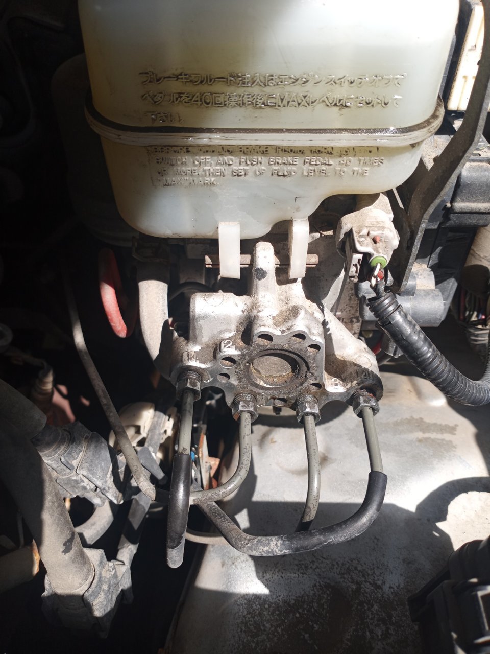

    I think I need to replace my master cylinder. I was checking the price on it and want to know if the dealership is the only place to get it? Do tacomas have 2 different styles? Do I have the crazy expensive one that you have to get from the dealership? Looking online (rockauto, Napa, advanced, O'Reilly) there are some for about $100 but do not look like what I have.
    Thanks

    Yes. They have a hydraulic or vacuum booster.
    Yours is a hydraulic. It’s more expensive.
