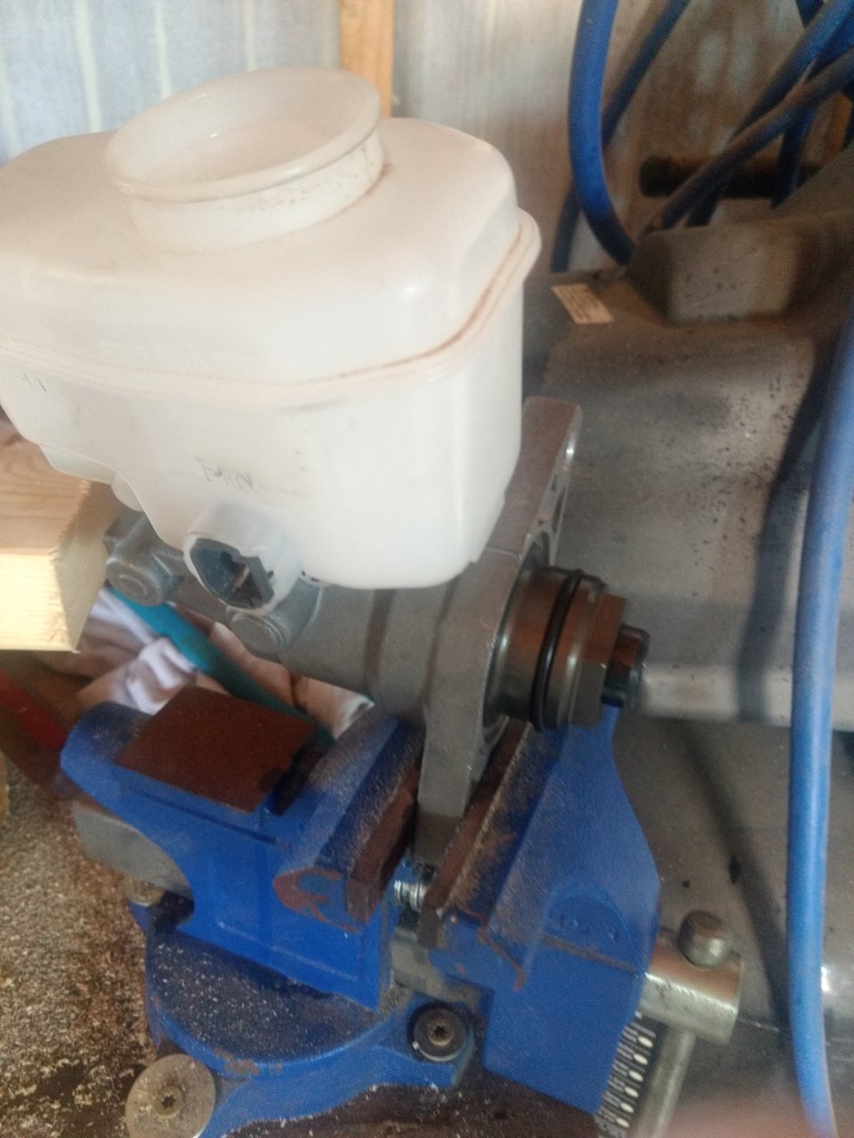

  16. Jul 17, 2019 at 12:20 PM
    #16
    05prerun82
    05prerun82 Your local friendly Taco Mule TTC#0202
    Aug 11, 2018
    #262485
    19,804
    Brandon
    Fredericksburg
    2006 aclb prerun
    Memphis sound system volant cold air intake
    Mine having problems IMG_20190717_141245110.jpg its stuck won't come out
