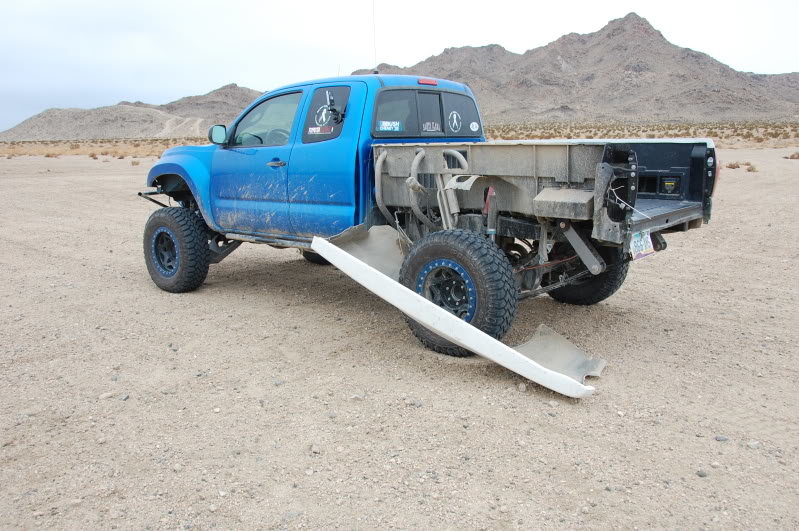

    Damn thats pretty impressive, what do they attach to? Or do you just use what toyota had the stock bedsides attached to? Also are those bedsides the normal glassworks bedsides? I might be buyin the TT bedsides. Your truck looks great man.

    They attach to all the stock mounting holes for the most part. You will have to use your own nuts, washers and bolts. You can even see on the fiberglass *about* where you have to drill for the new hole. It has like a rough spot of where the hole should go. I only had to make 2 mounts per side and those were just the mounts that held the very bottom of the glass, so by the exhaust tip and bottom of the glass by the cab. I had to shave part of the actual bed for the glass to fit right. The bed has these little bumps where the bolts go into the track for the tie downs
    they looked kinda like this...hope this text displays right and this would be a really zoomed in version. They are currently under your stock bed sides. You'll see em when you take em off.
    ____/¯¯¯¯¯\___________/¯¯¯¯¯\___________/¯¯¯¯¯\___________/¯¯¯¯¯\
    after I shaved they were like this and the glass sat lower and the holes lined up better
    _______________________________________________________________

    No shaving of the stock bed with TT glass
